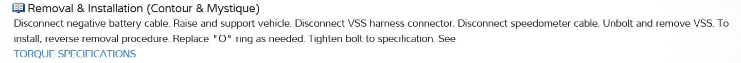

How do I install a speed sensor on my car?

Unplug it, unbolt it take it out and put new one in. It is on lower rear of trans-axle no picture available.

Found instructions.
Image (Click to make bigger)
