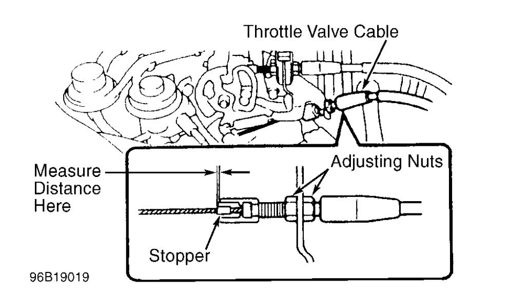

hello, we changed the speed control cable, and we connected it and it was working fine. When we stopped using it 15 minutes later, the reverse shift wasn't working. What do you think is the reason for this?

are you talking about the accelerator cable? check to see if cable to trans is correctly adjusted 0-1.0mm see pic

No I think it's called throttle cable assembly

throttle and accelerator are the same cable check the one for transmission also check for a vacuum leak or hose dislodged.
