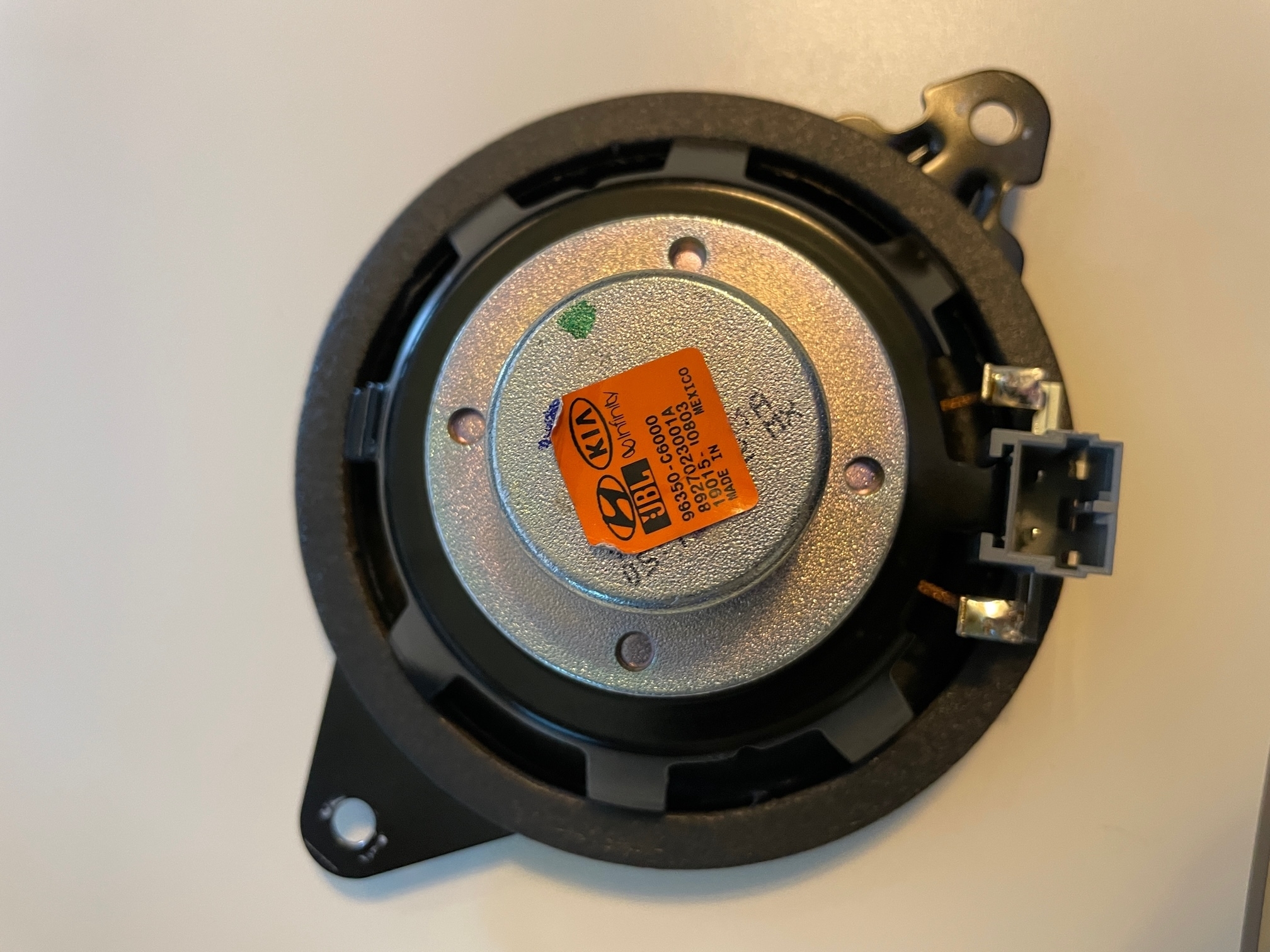

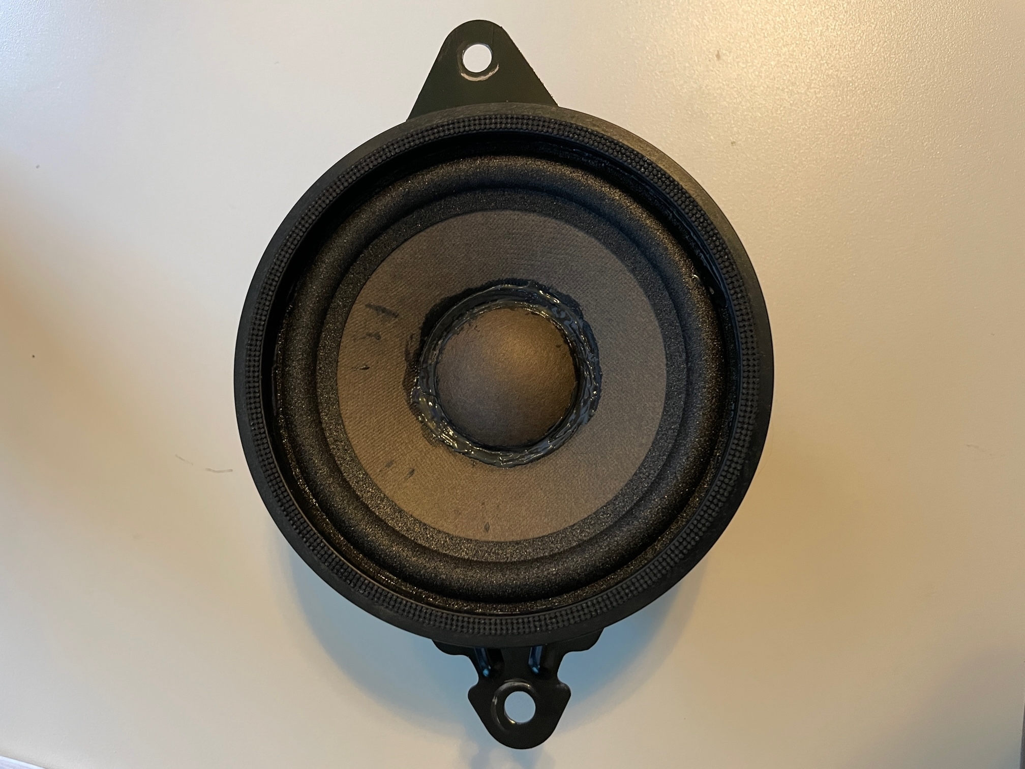

The ~4" mid dash speaker is making a noise akin to when the insulation of or the foam has a loss of integrity and will replace it. I have the upgraded Infinity/JBL audio system. I removed the full range (not coaxial) mid-range speaker to try to identify the impedance, OEM model #, etc. I could only find a JBL sticker with the OEM model #96350C6000. I used a meter to estimate the impedance @ 4 ohms (meter registered ~3.5 and I read that these measurements are within range for a 4 ohm unit). I have not been able to find any info. about the OEM speaker's freq. response and RMS ratings for min and peak. This info. would be helpful for finding a system compatible with aftermarket speaker. Of course, I will then have a challenge finding one that fits the internal dashboard mounts, but that's another fish to fry. BTW, the OEM replacement is around $240 - not going to happen.

Thanks for the images, Finding detailed specifications for OEM speakers can sometimes be challenging.

Thanks to both above respondents to my query about how to replace that dash speaker on my Sorento. I did finally figure it out by buying an aftermarket speaker and adding some extension washers to reach the two screw connections. It was somewhat of a laborious process, and I posted the process and pics on the Kia-Forums.com site and forgot to do so here. Perhaps this link to my post on the aforementioned forum will work for you. https://www.kia-forums.com/threads/replacement-for-infinity-center-dashboard-speaker.362957/#post-2127529
