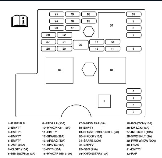

I've attached 2 pictures below of where the main radio and amp fuse location as you requested.They are located on the BCM- body control module in location numbers 6 and 23. Hope this helps and thanks for using 2CarPros.

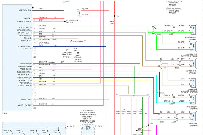

If the fuse is bad, it won't work on and off. What are we dealing with? Is it a factory radio or an aftermarket? Also, did this happen to all speakers at the same time?
Some of these vehicle have an Amp and some don't. Are you sure there is one? I'm only asking because you indicated it was a basic original radio.

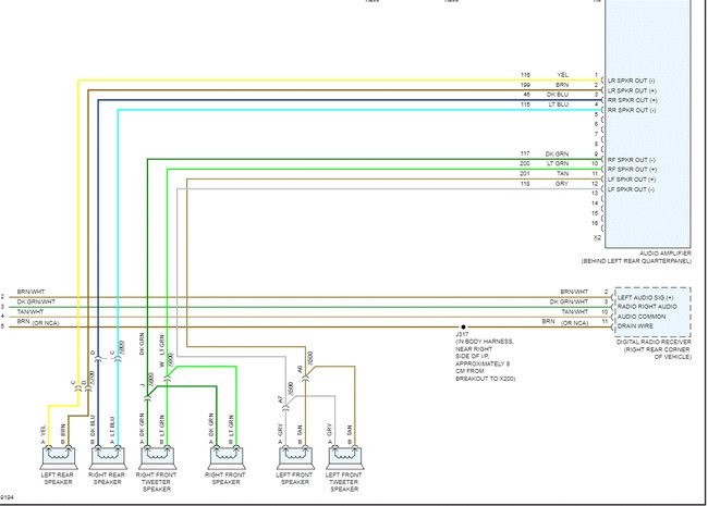

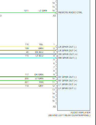

If you look at the two pics below, I attached wiring schematics. If this is something that has affected all speakers at the same time, chances are it is a connection issue and not the speakers.
Check the connections in at (either the amp, Pic, 1 or the back of the radio, pic 2).

I'm in agreement with Joe as well that if a fuse went bad it won't work at all. If you stereo system has an amplifier option it's located behind left rear quarter panel.Hope this helps and thanks again for using 2CarPros.
