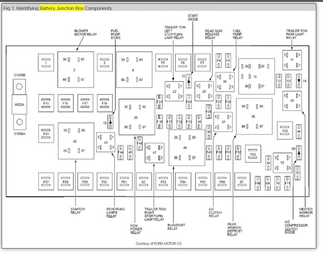

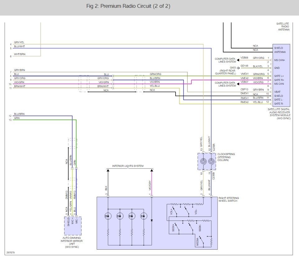

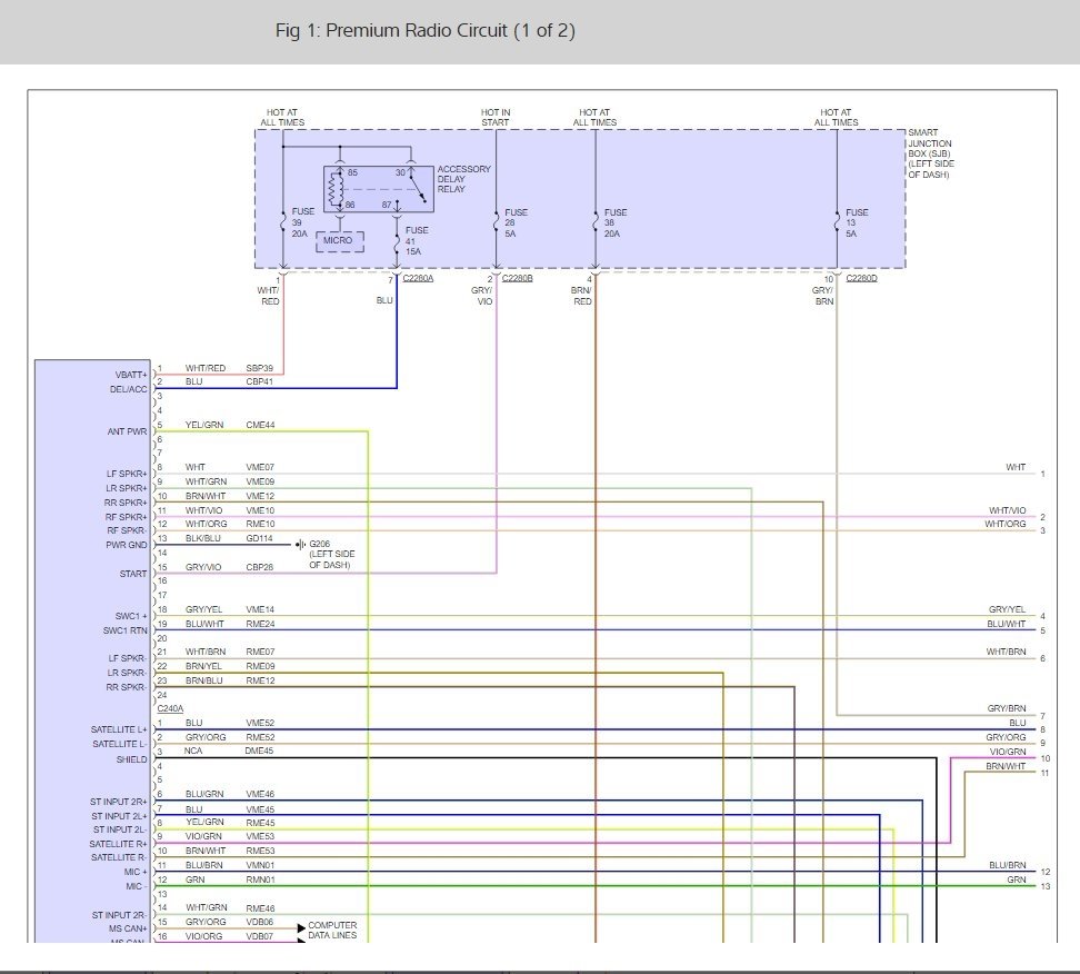

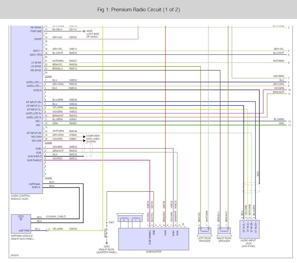

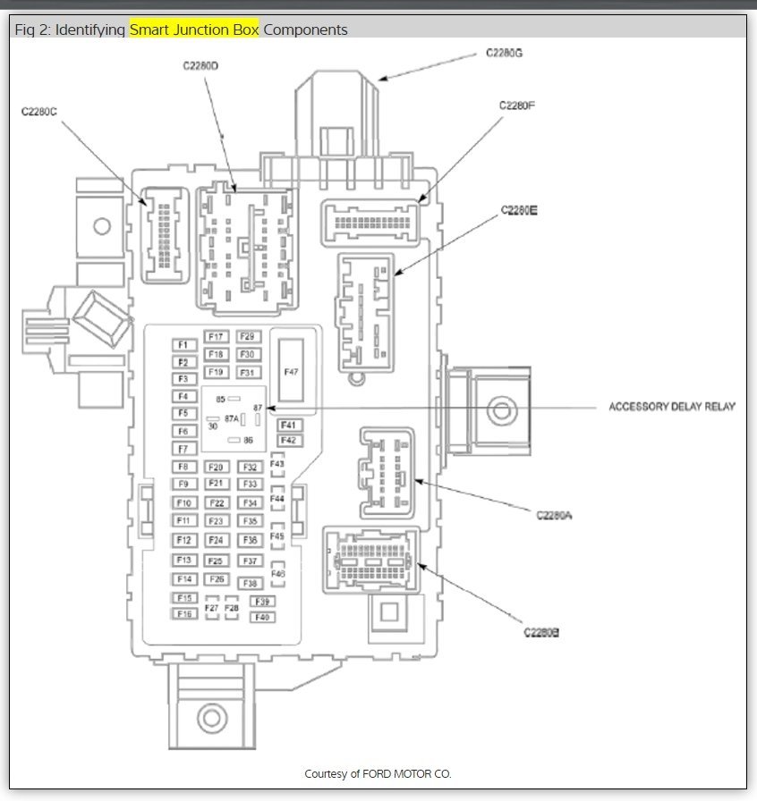

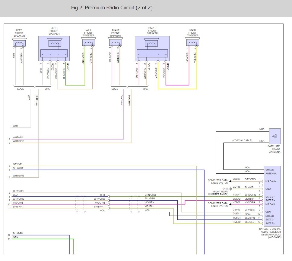

It sounds like you blew a fuse, here is a wiring diagram and fuse box locations (below) so you can test the fuses by following this guide.
Please run this test and get back to us we are interested to see what it is.
