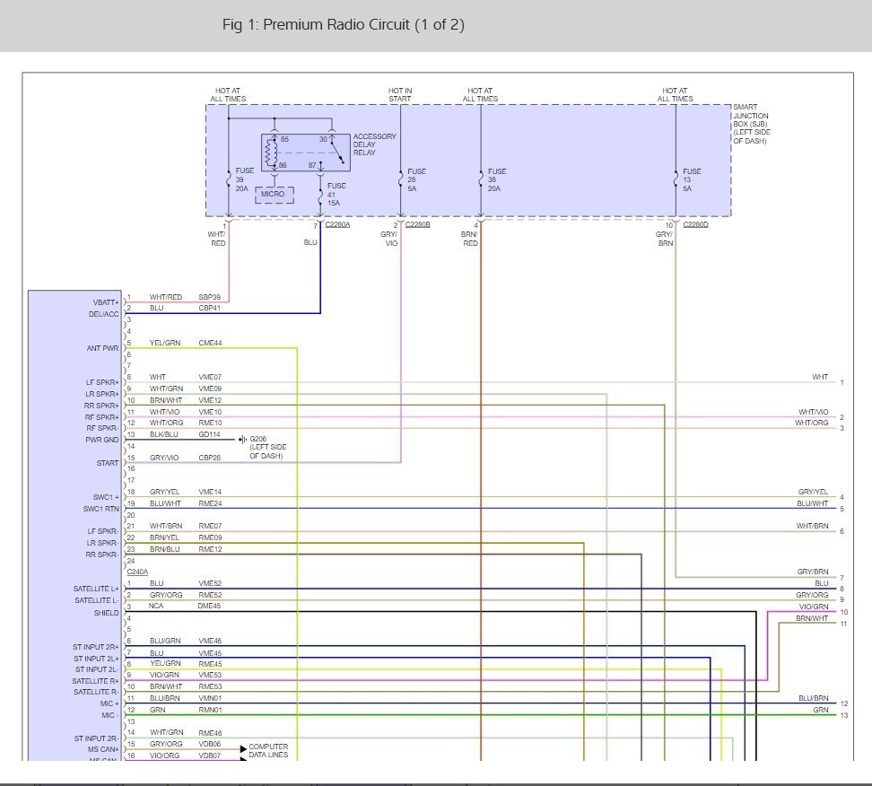

Okay, I cannot fathom why this affected my speakers, but I was driving in a construction area when I felt and heard a big bump on top of the car. It was as if something fell on top of the roof. It was loud and it made me duck my head.
I had been listening to XM radio before the noise, but after I recovered from the scare, I noticed that the radio had gone off. I tried turning it up and the interface showed that sound was there, but there was nothing coming from the speakers.
On inspection of the car, I found no evidence of damage.
Weird
Jul 7, 2017 at 6:31 AM
  • 54,837 POSTS

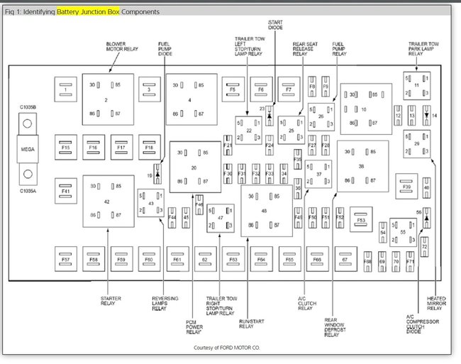

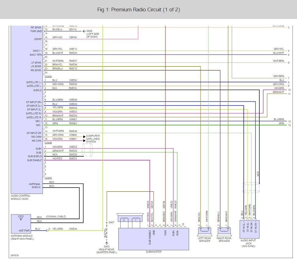

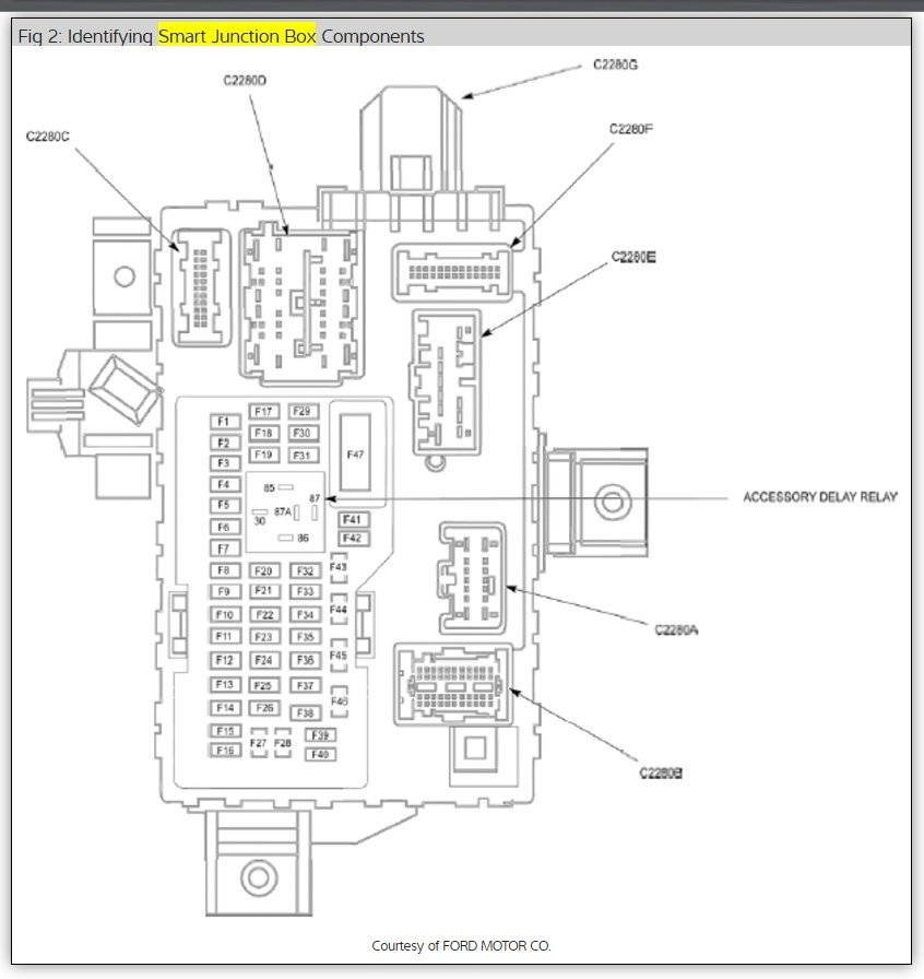

It sounds like you blew a fuse, here is a wiring diagram and fuse box locations (below) so you can test the fuses by following this guide.
Please run this test and get back to us we are interested to see what it is.
