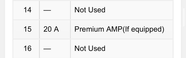

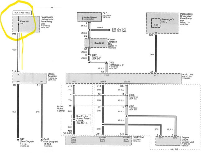

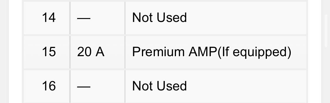

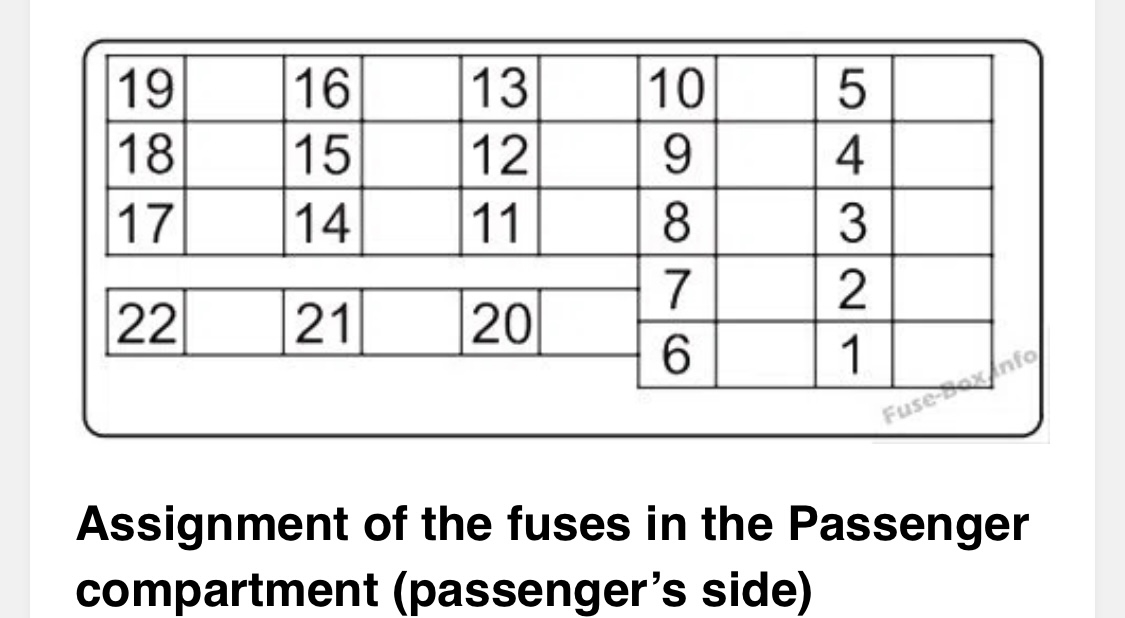

I found the issue but found another problem. It was the #15 fuse for the Premium AMP, it was indeed blown. However, when trying to replace it with another fuse, I’m getting an electric shock coming from the port and it is simply scorching the new fuses. what is the issue?
Apr 4, 2022 at 1:20 PM
STEVE W.
  • 15,345 POSTS

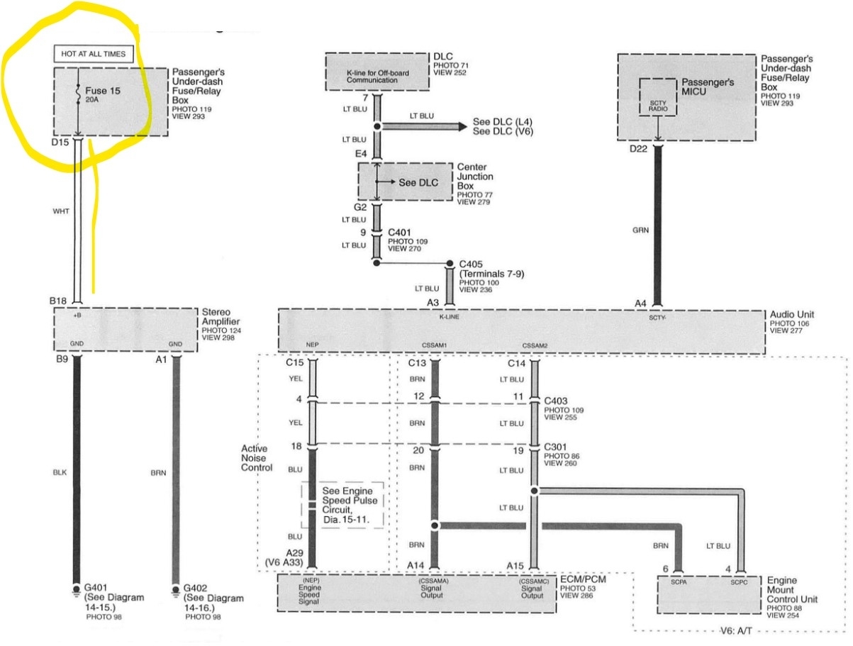

Okay, you found the blown fuse. Go to the amp and unplug it and see if the short goes away. Very possible the amp just failed internally. If you unplug it a quick way to test and not cost a fuse would be to put a test light across the fuse terminals. If it still lights up with the amp unplugged the wire itself has a short. If it doesn't the amp is the problem as it is the only item that fuse supplies power to.

Disconnected the amp then plugged in the fused and it worked!! Speakers are back on! Thank you, sir.
