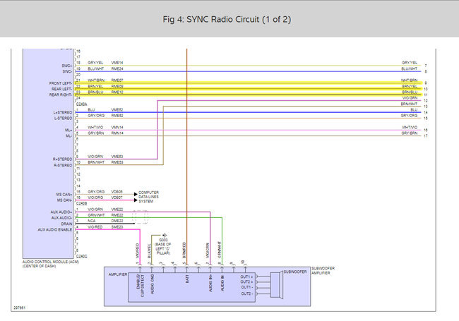

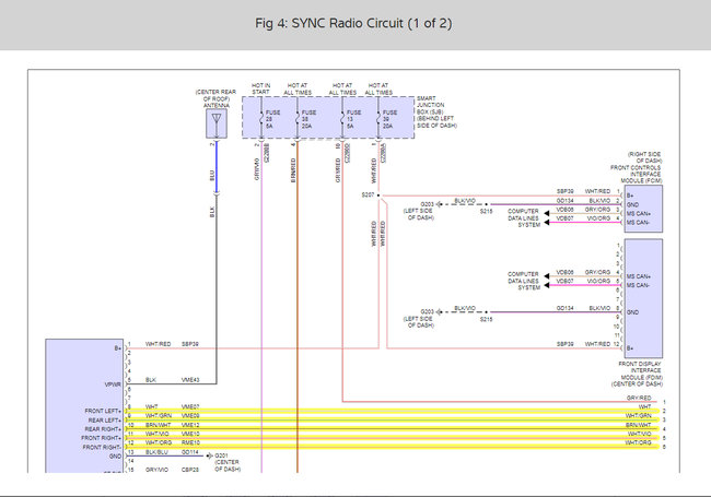

My car has been setting for a year, but recently got in it and now my radio speakers won't work. Radio display works fine, but no sound. How can I fix this?
Jun 13, 2019 at 11:47 AM
SCGRANTURISMO
  • 4,897 POSTS
I would double check the connectors on the back of the stereo. Which stereo does your vehicle have, the base radio, premium radio, or SYNC radio? I can send you instructions on how to check these connections when we get the right radio. We just want to send the right information to you, that's why we ask.

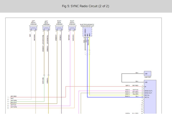

Yes, thanks for responding, but it's the sync radio.
Jun 15, 2019 at 12:45 AM
SCGRANTURISMO
  • 4,897 POSTS

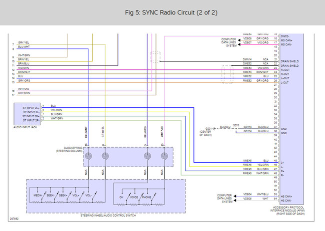

Hello again,
In the diagrams down below I have included the wiring diagram for your vehicle's radio. Please ensure that the highlighted wires on the wiring diagram are connected in the connector and that the connector is good and tight. You also want to check that the antenna wire is connected good and tight as well. Please get back to us with what you find out.

Thank you! Everything seems to be connected well and tight.

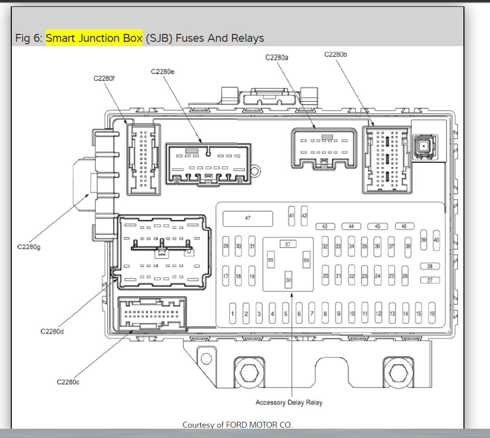

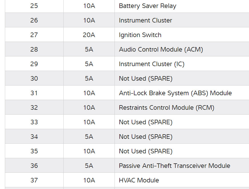

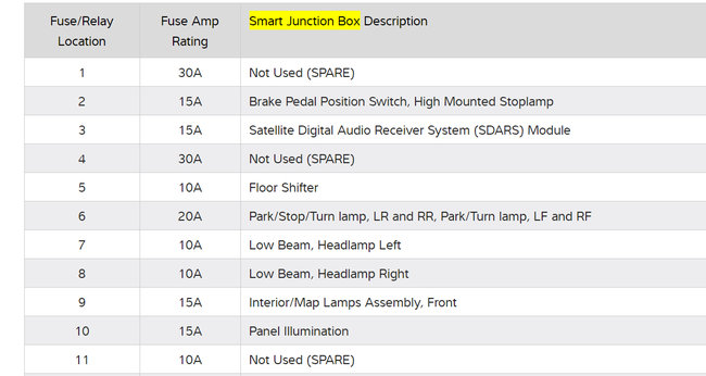

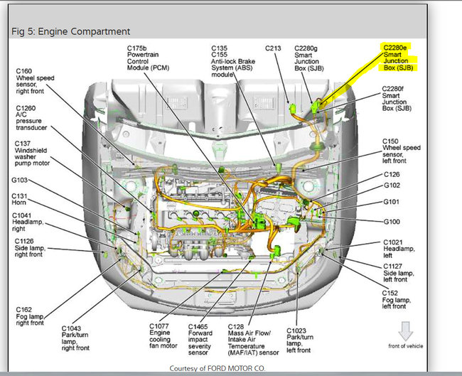

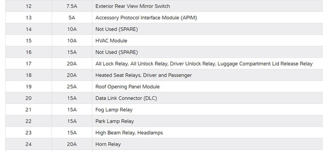

No still isn't working. Is there a fuse that I'm not aware of that could be blown?
Jun 17, 2019 at 9:51 AM
SCGRANTURISMO
  • 4,897 POSTS
Hello again,

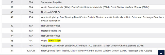

In the diagrams down below I have included a diagram of the Smart Junction Box which is under the left side of the dash. The fuses that control your stereo are fuse #28,38,13,39. Check these fuses and get back to us with what you find out.

Thank you! I'll check it out later. Is there a amp fuse, if so wheres it's location?
Jun 18, 2019 at 2:28 AM
SCGRANTURISMO
  • 4,897 POSTS
Hello again,
Yes there is. It is fuse #38(20A)(Subwoofer Amplifier) in the information that I sent earlier.
