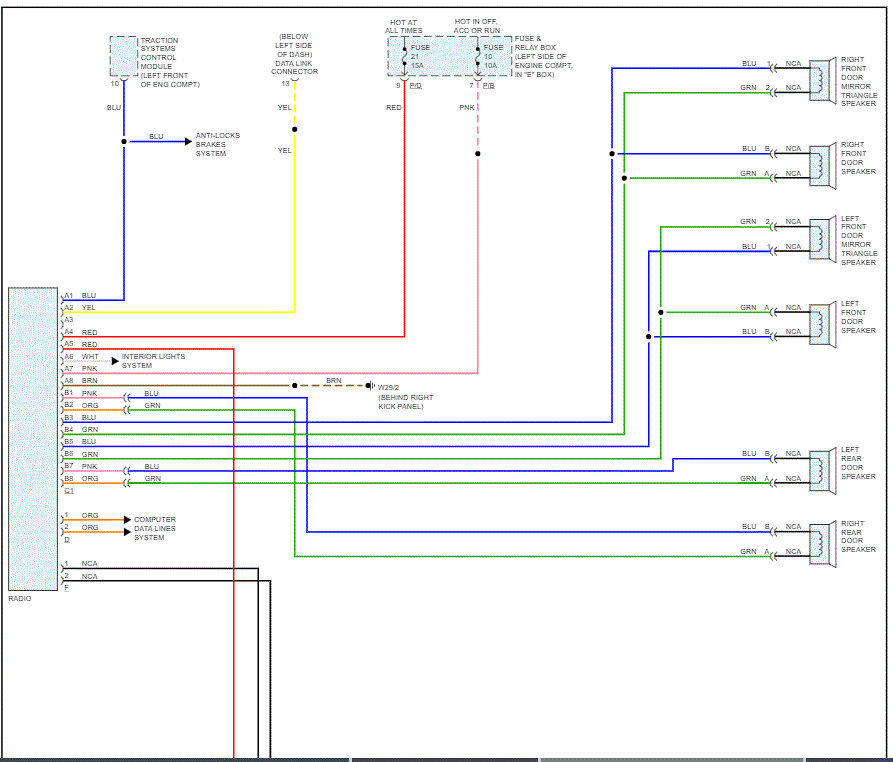

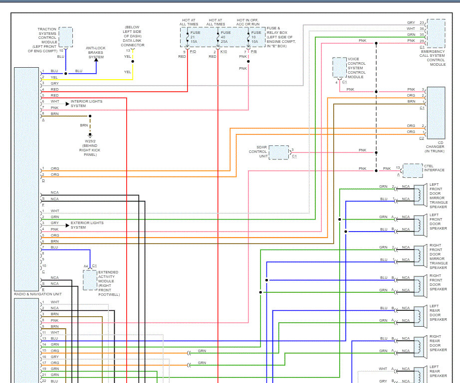

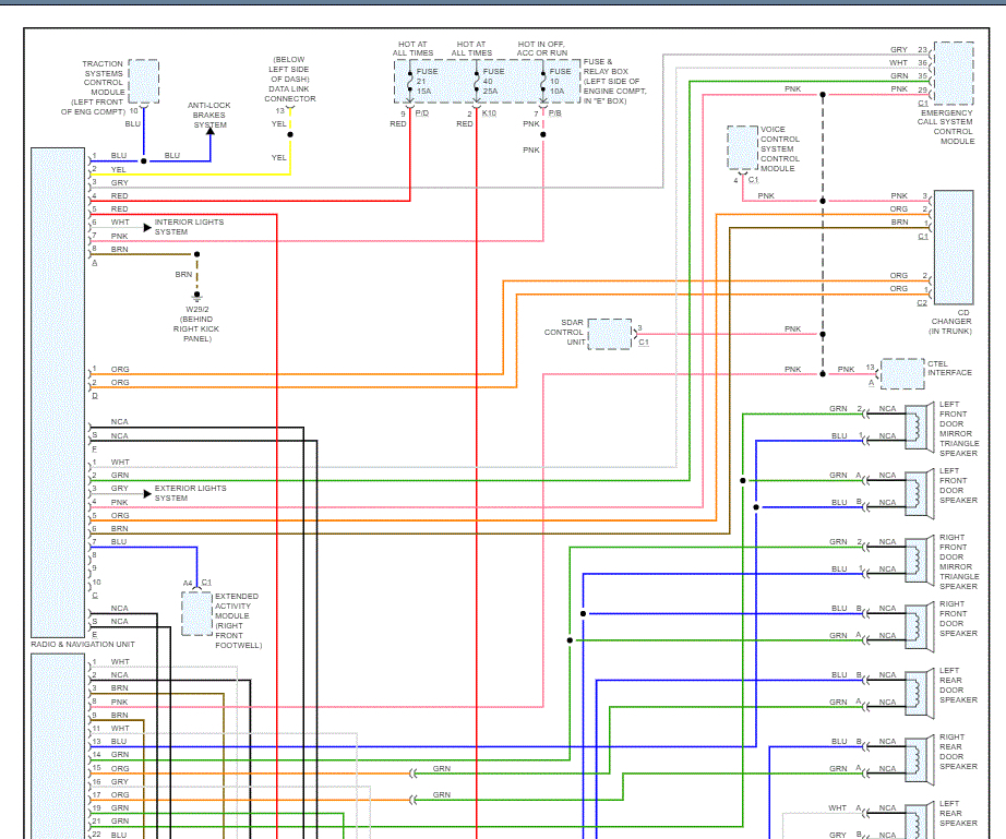

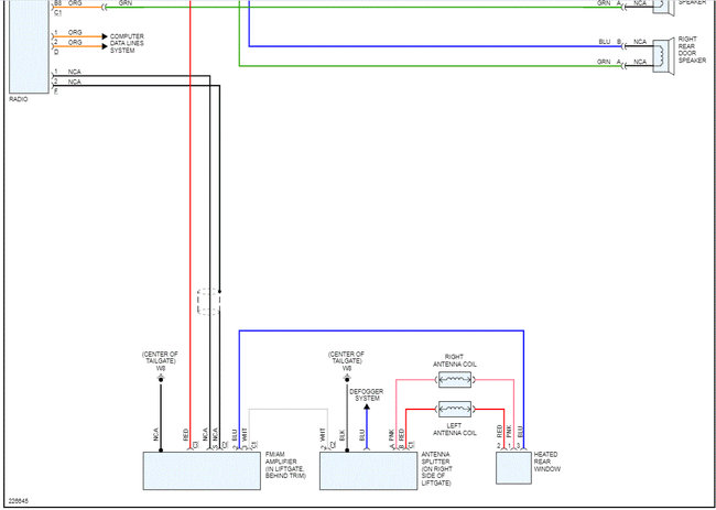

color code for speakers.
Apr 22, 2020 at 1:00 AM
  • 110,194 POSTS
Are you looking for wiring info?
I attached four pics below. They were actually two pages, but I cut them in half to make them readable. The first two are page 1. The second two are page two. They both indicate wiring color to speakers. I hope this is what you meant.
Let me know if this helps.
