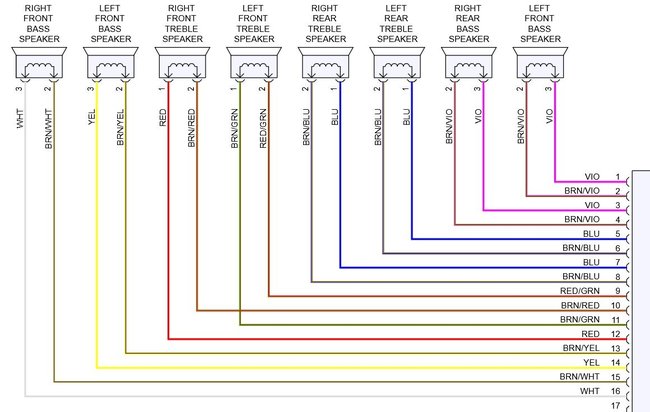

I'm trying to figure out the rear speaker colors and I can't find it online. I get way too many different answers.

Here ya go! Good luck, if you need anything else let us know.

Thank you. So, is the 1 positive then? I can't find the answer. Thanks again

All the colors on the left are +.
