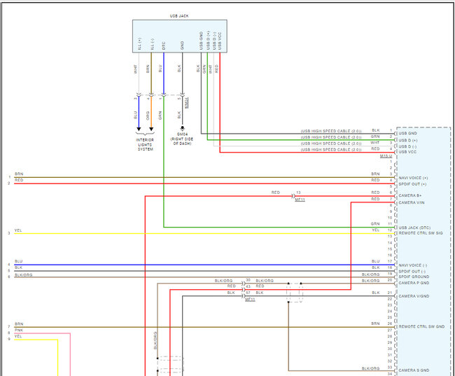

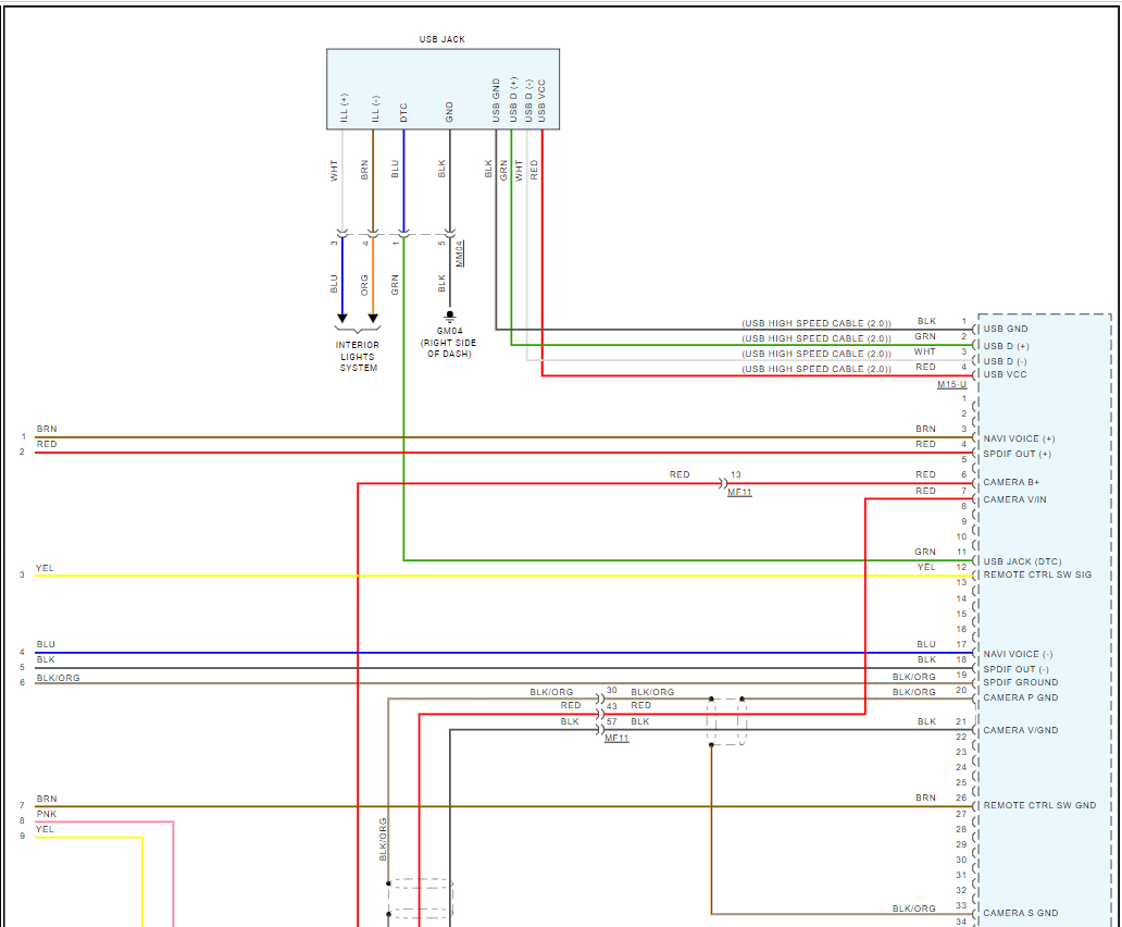

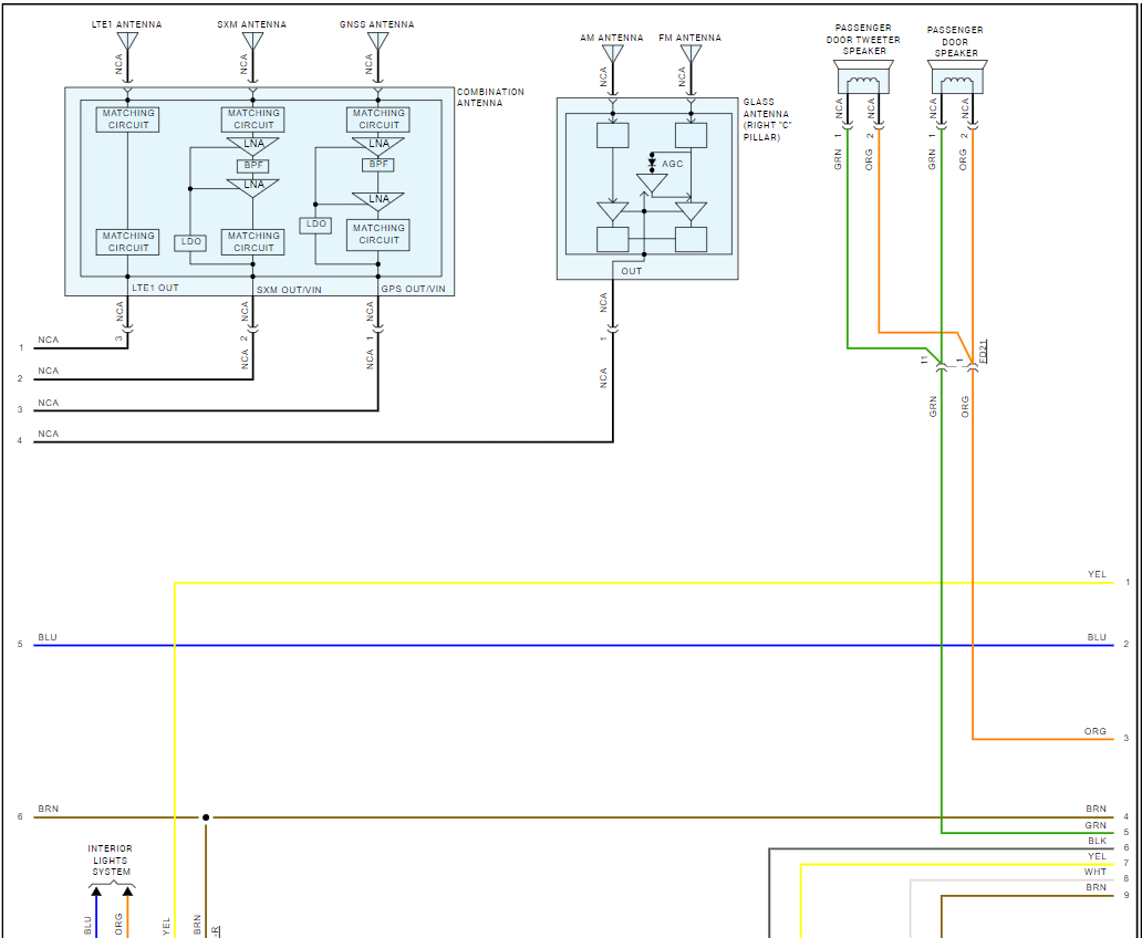

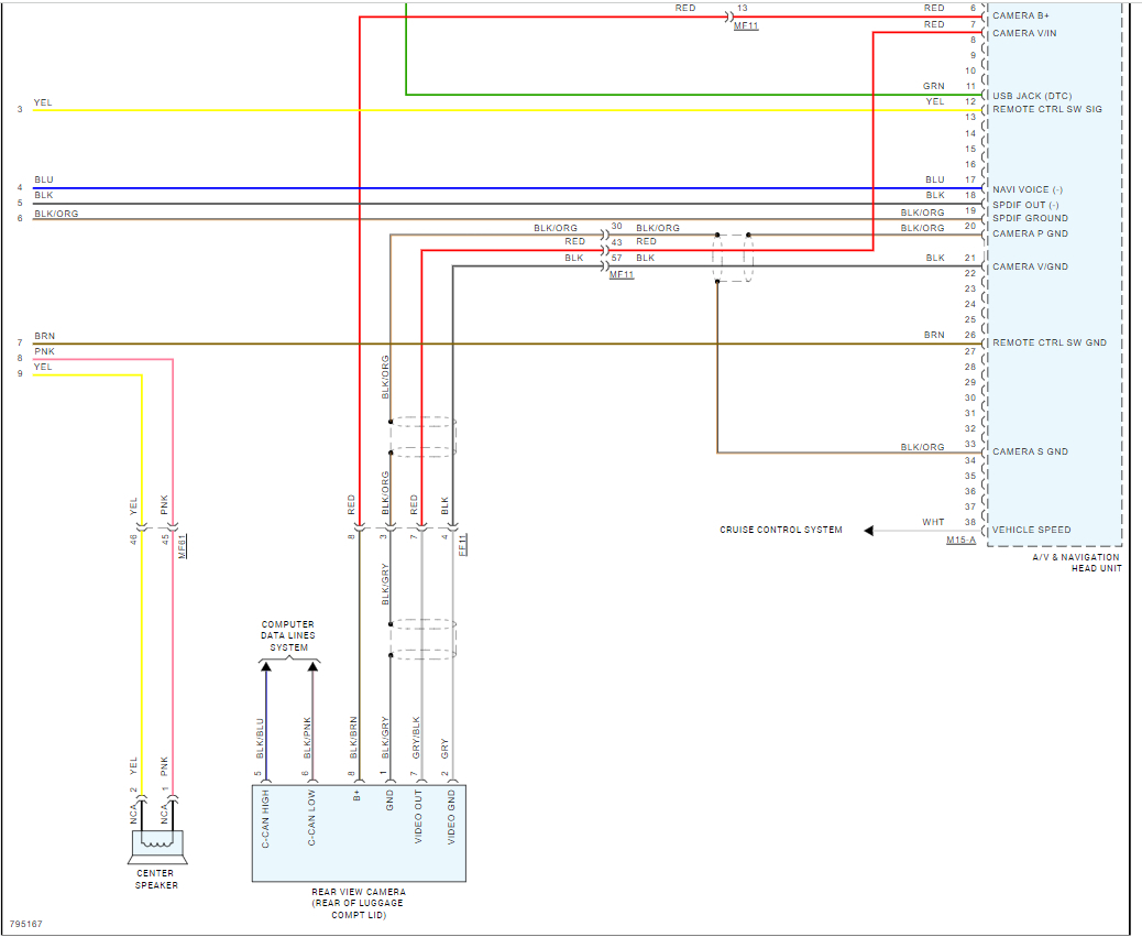

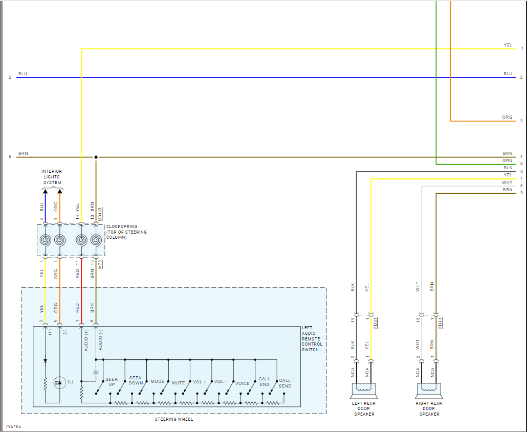

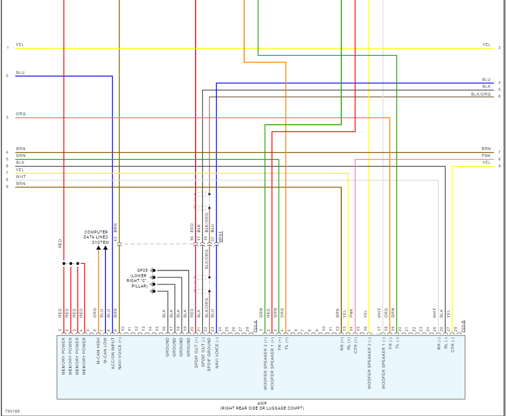

I'm looking for a speaker wiring schematic for the vehicle listed above with amp. Replacing the speakers in the doors and looking for the proper positive and negative colors for the wires going to each speaker.
Dec 18, 2023 at 6:54 PM
  • 55,402 POSTS

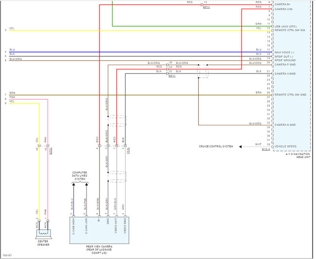

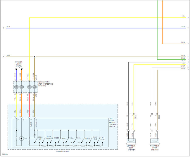

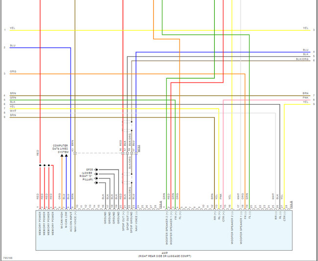

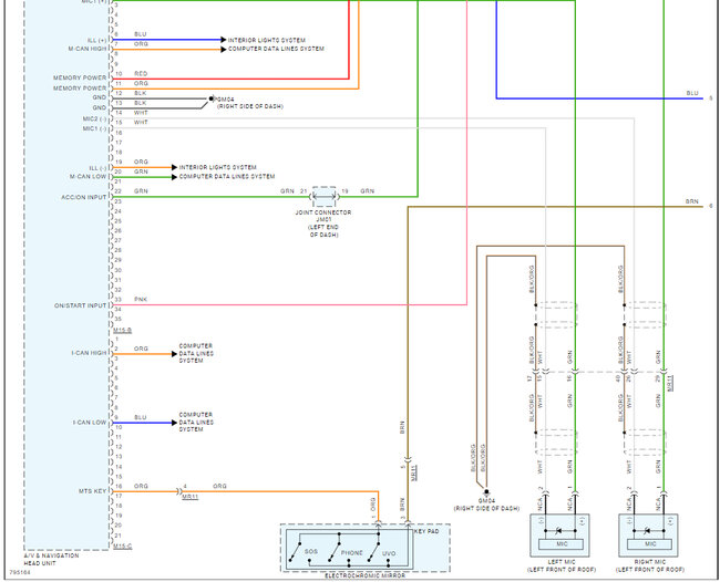

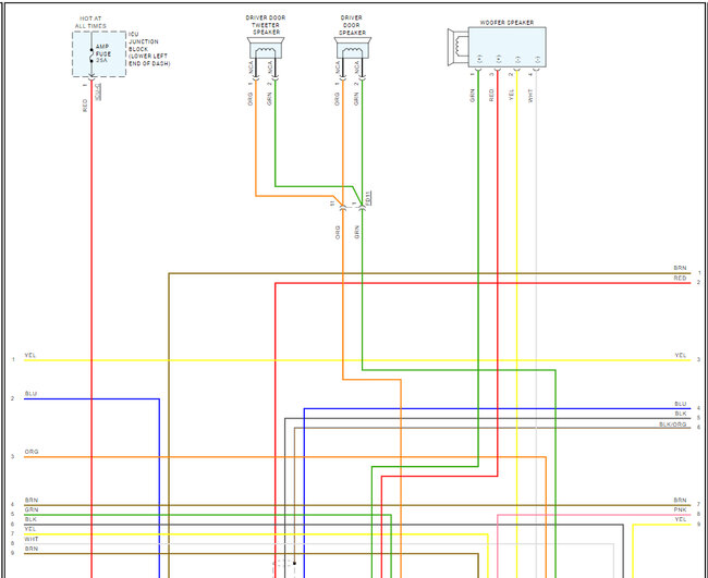

Yep, the stereo will sound better if you get the polarization correct. Here is the radio and speak wiring and which is positive and negative. Check out the images (below). Please let us know what happens.

Menu, many thanks for this!! Sorry for the delay in responding. This is exactly what I was looking for and more. Speakers installed flawlessly now and sounding great!
