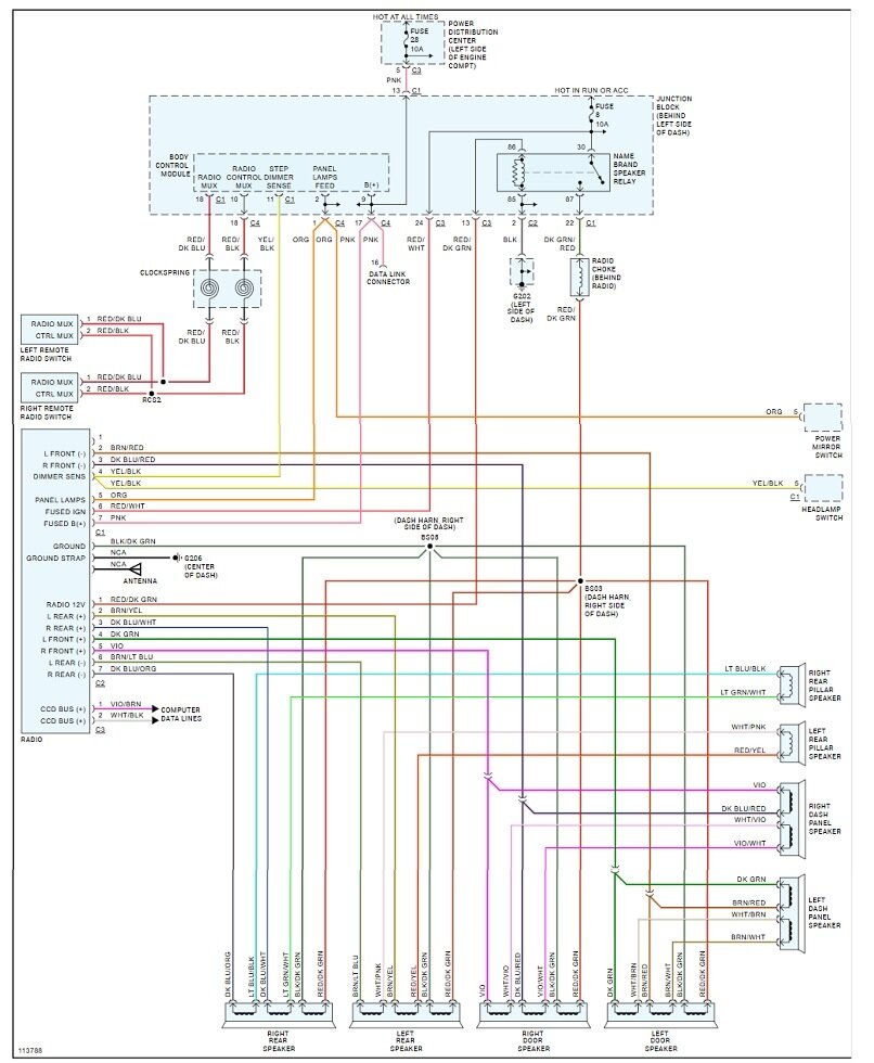

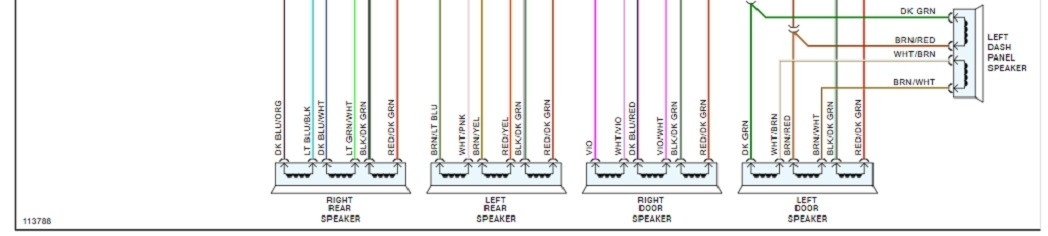

Got new 6x9s. I gave up on finding replacements for 6-pin connectors. One speaker was missing, and the new speakers only have 2wire spades.
So, I cut the 2 wires I needed and left the other 4 in the connectors hoping for the best.
It's not very loud and sounds like it's in a tunnel.

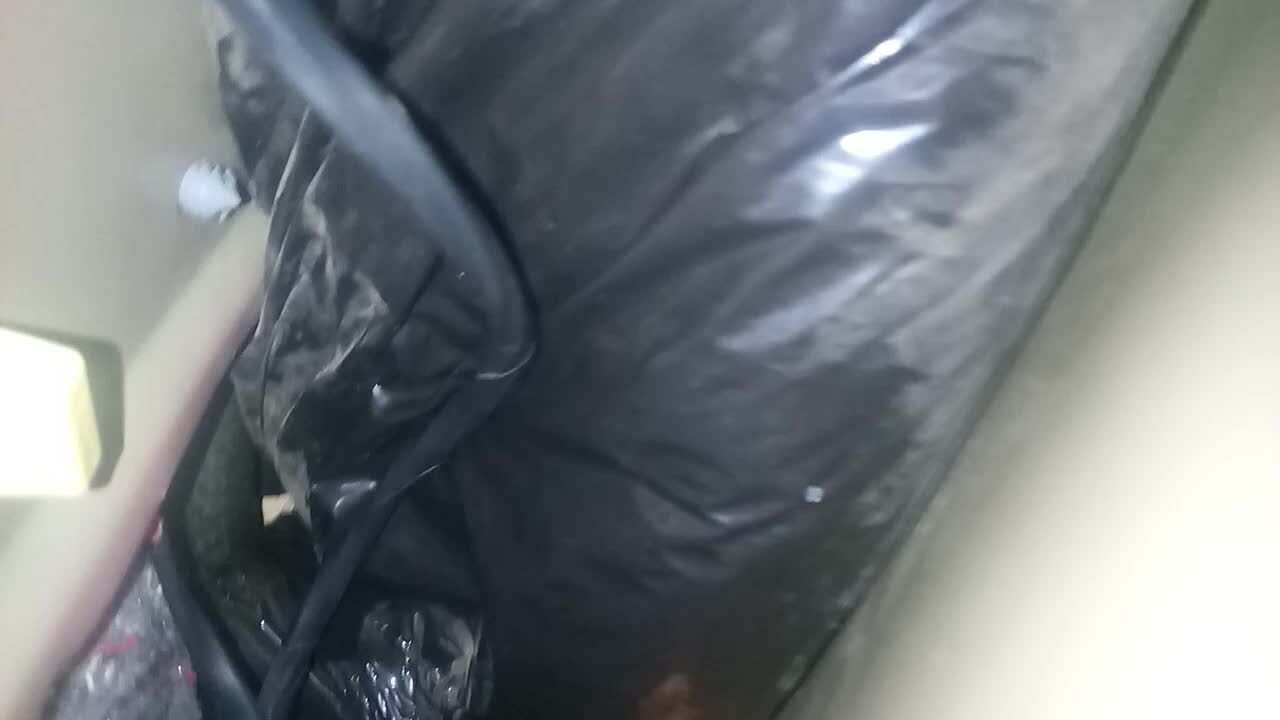

There's an amp in the back.
I'm not sure what I need to do.
I drove and called every store within 50 miles and searched every website I found for 2 weeks looking for the 6pin connectors.
I appreciate any advice you can give!

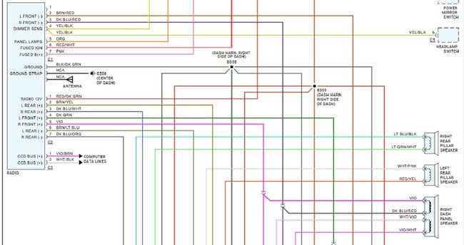

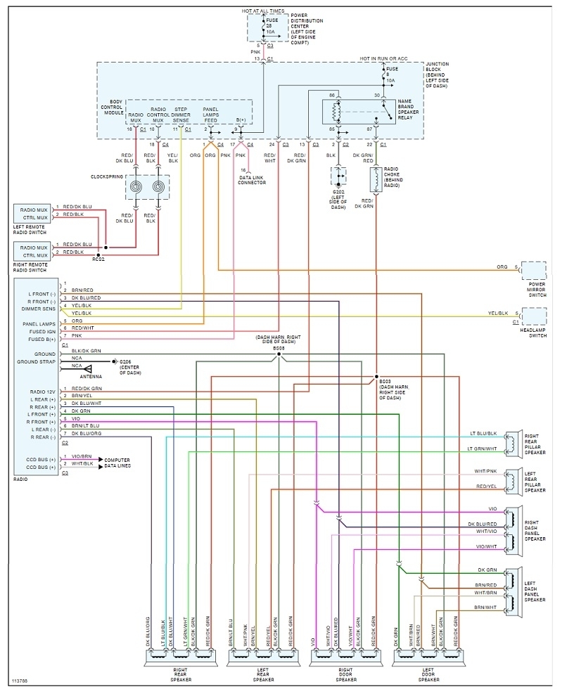

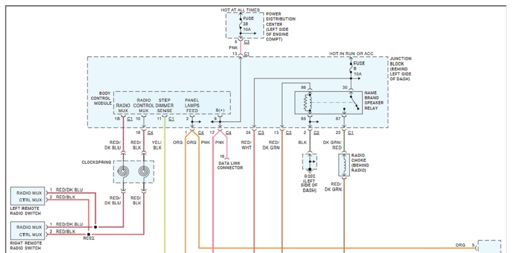

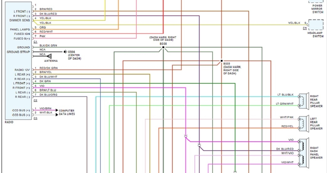

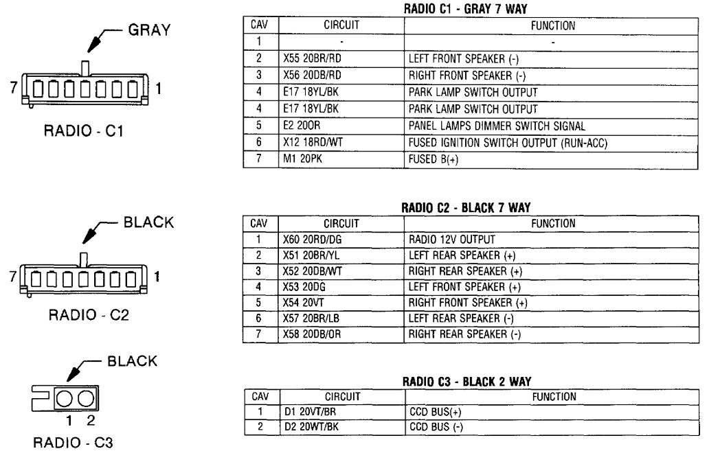

You'll be better off finding the right speaker in a salvage yard. Nothing aftermarket will sound right in this application. I posted the wiring diagram in case you need it. The first one is three parts I put together. The next three are pieces I tried to expand for easier viewing. The last one is the radio connectors. These plugs are the same as far back as the mid 1980s, but were changed on various models beginning around 1998 to 2003. They don't show the speaker connectors. You'll have to go by the wire colors.
The original door speaker has two speakers built together. That accounts for four speaker wires. The last two are the 12-volt feed and ground for the built-in amplifier. That tells me you have the "Premium" system. The factory radio is a little different. The output circuitry is modified to develop less-than-normal bass. That is made up in the amplifiers. When you use a non-amplified speaker, you will have to turn the bass up as far as it will go to sound close to right. You can also find the same radio for the "Base" system. It looks and operates exactly the same, but it develops the normal amount of bass. The problem is all the other original speakers will still be over-amplifying the bass, so for them to sound right, you have to turn the bass all the way down.
You can identify the radios by finding the word, "Infinity" on the faceplate for the premium version. Some other models use separate remote-mounted amplifiers for their Infinity systems. You can use standard speakers with those systems.
It's also important to be aware that with GM and Ford radios, when they use an amplifier, those radios must be used with an amplifier or you won't be able to hear the sound, and when they don't use an amplifier, you can't use it with an amplifier. Chryslers are different in that regard. All of their radios put out speaker-level output, regardless if they're used with or without an amplifier. Only the tone conditioning is changed with the amplifier(s), for the shape of the vehicle's body. They don't increase power or volume.
It's also worth noting these radios always have four channels corresponding to the four corners of the van. When they use more than four speakers, as they do here, some are in parallel, which means one will still work if its mate is unplugged, but some of yours are in series, meaning current has to flow through both of them for both to work. If you unplug one of those pair, neither will work.
When two speakers are in series, each is designed to work properly with half the audio signal the others use. Rewiring them like standard speakers will make them much too loud and usually distorted. Distortion comes in three forms. One is when part of the signal is cut off. That happens in the output circuitry, which, in this case, is in the remote amplifiers on the speakers. The second form of distortion is when the speakers don't get the correct voltage and frequencies they are designed for. That's what you're experiencing. The third type is when the speaker's voice coil has moved to its physical limits, but the signal voltage is asking it to move even further. In that case the voice coil is not moving in a smooth relationship to the audio signal.
You should be able to find a replacement speaker in any pick-your-own parts salvage yard. Do a search for "Pull-A-Part to see if there's a yard near you. I've been to 16 of them. All were very clean and well organized. You can do an inventory search to see which yards have the same van, but they can't tell you colors, options, or which parts are gone or broken. There are a lot of similar yards popping up all over.
There were a number of similar radios Chrysler used throughout most of the 1990s. If you have a CD / cassette combo, those are by far, the best radios I have ever worked on. I used to recommend them for upgrades from the CD-only radios or the cassette players. Often people bought a used vehicle and wanted to upgrade from cassette to CD, but stick with a factory radio. I always told them the CD / cassette combos were the best choice, even if they didn't own any cassettes. Those radios were built by Mitsubishi and had the "Supplier #" 28046 on the model sticker.

To make things more complex- it's a Mark 3 conversion van with a whole entertainment system, more speakers, switches, jacks, 2cnd radio ect.
