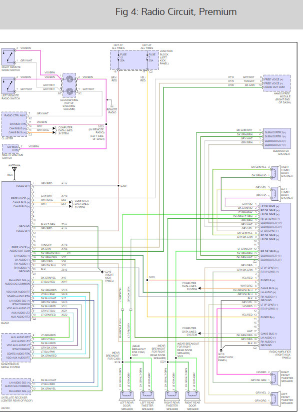

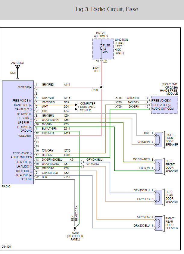

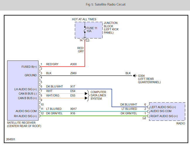

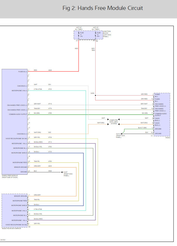

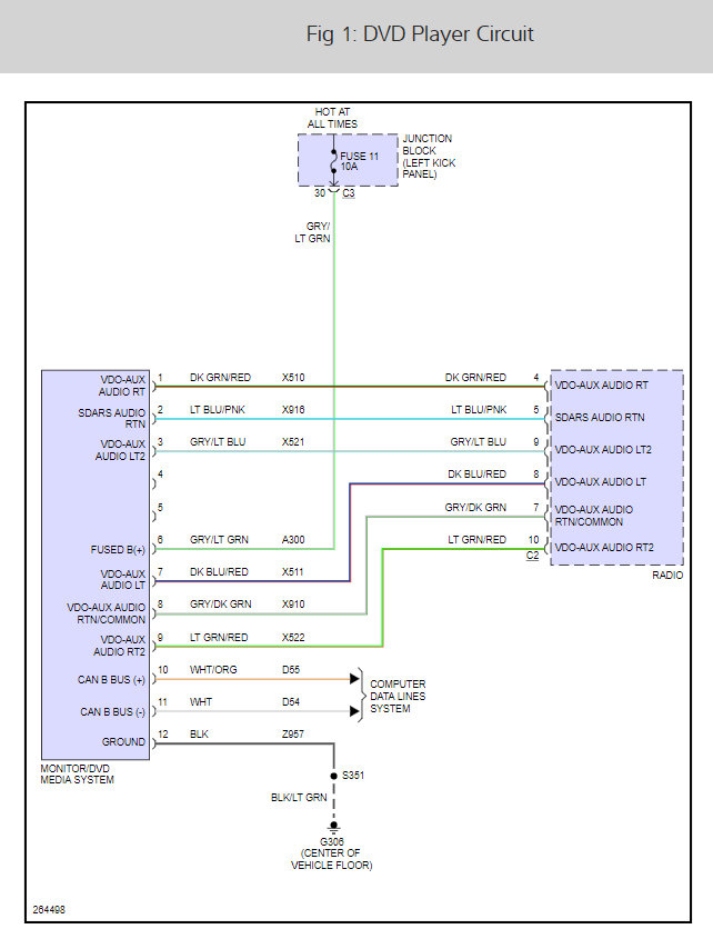

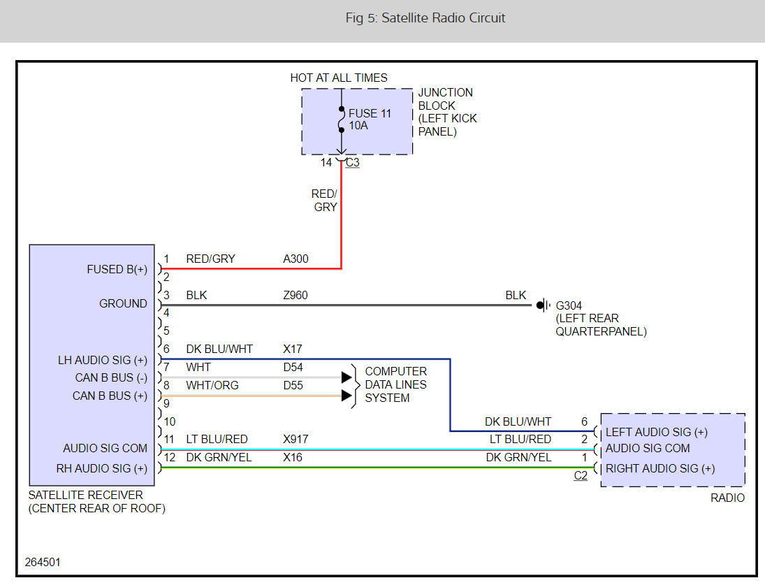

i need a wire diagram for the input output wire coming from factory amp.

Here are all of the radio and amplifier wiring diagrams I can find (below) let me know if you need them to be larger i can cut them in half and upload them.

Right on. thanks so much been looking everywhere to no avail. thanks again, really appreciate it. you rock!
