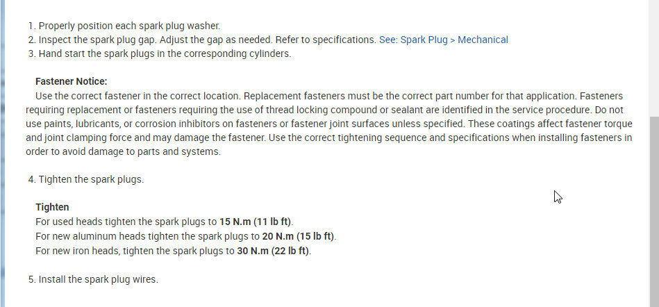

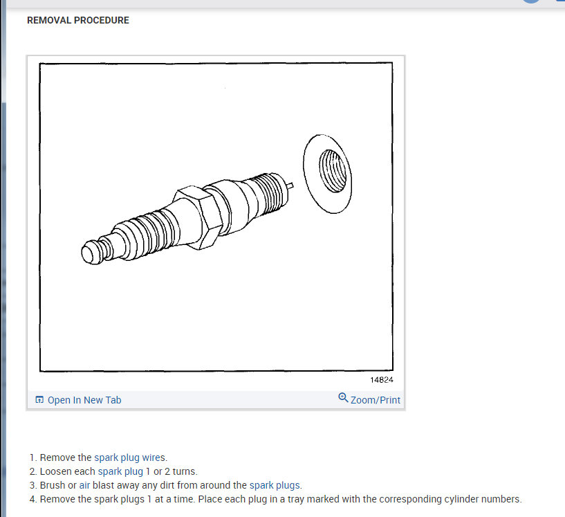

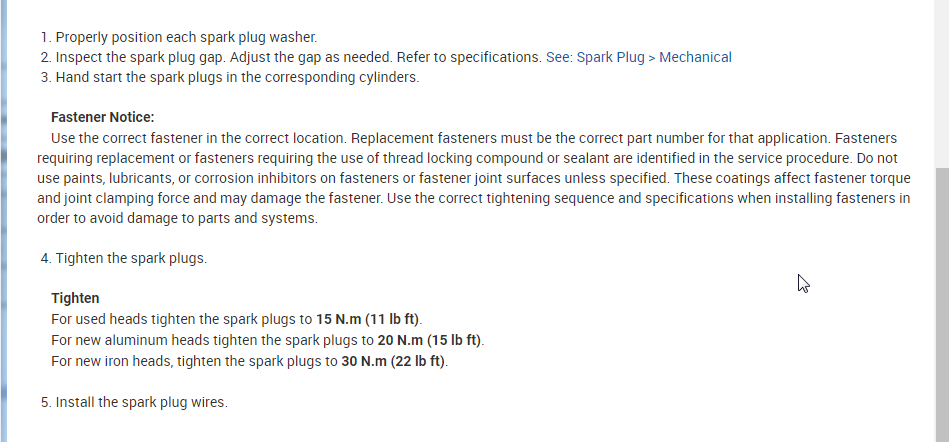

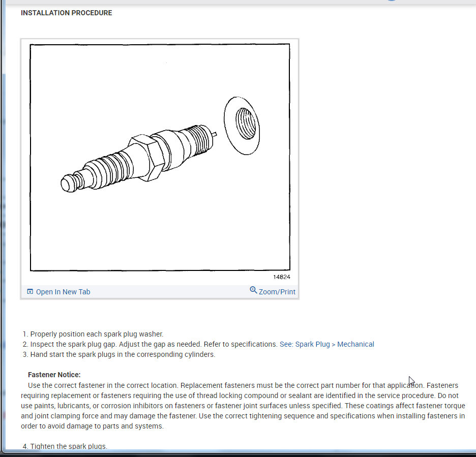

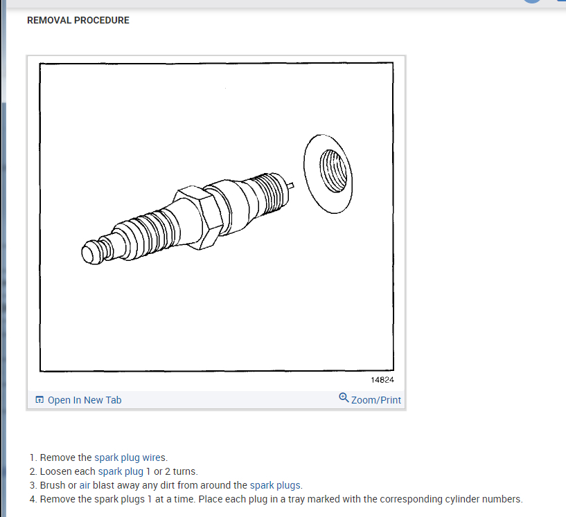

However, I attached below the documents on how to replace the plugs if you need that as well.
