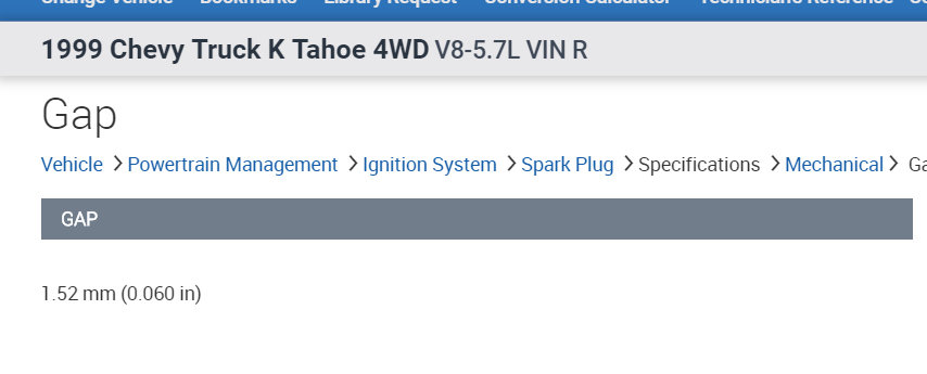

Just change my spark plugs and all passenger side of engine spark plugs were black the others were okay. What is the problem?

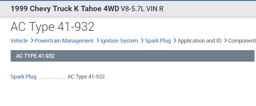

Usually black sooty spark plugs is caused by an overly rich condition. This could be caused by a bad upstream O2 sensor. Can you double check and make sure the spark plugs from the other bank and this bank are exactly the same. Another cause could be a different heat range spark plug was used on this bank and not the other. Just a possibility. Is your Malfunction Indicator Lamp (MIL) or "check engine" light illuminated? In the diagrams down below I have included what the Original Equipment Manufacturer (OEM) recommends for spark plugs and what the gap should be. Please go through these guides and get back to us with the information we requested.
