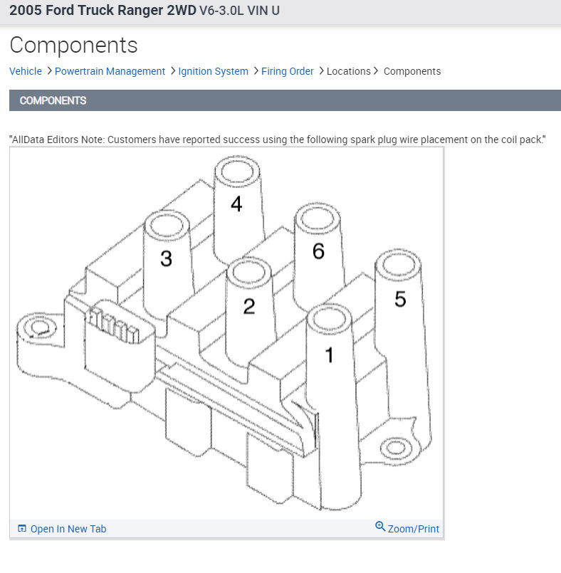

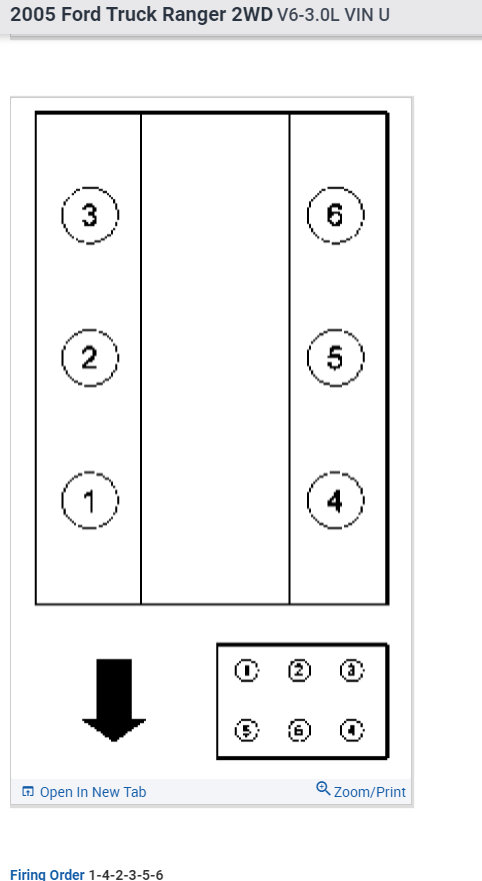

Hey guys, are you able to get me the sparkplug wiring diagram for the truck listed above? I recently changed the plugs and wires; I've done it one by one so that I don't miss wire on any cylinder. But anyways I have this ticking sound on I believe is cylinder 3, passenger side closes to firewall. And I can see the sparks when it's idling. I tried pulling off that boot to inspect and clicked it in again and same thing. I also didn't get any misfire codes on my obd scanner so Now I'm thinking is the wiring wrong. Anyhow if you can clarify this with me with some kind of diagram, I can follow that'll be great.

I have attached the diagrams showing the cylinder numbers on the coil pack and also the cylinder numbers on the engine.
This should help you determine which wire goes where.
How is the condition of the wires?
Are they in good shape?

Brand new wires. Good condition after inspection.

Thank you for the diagram I'll back track this.
