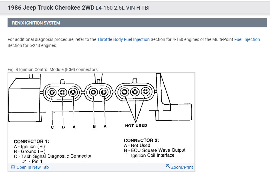

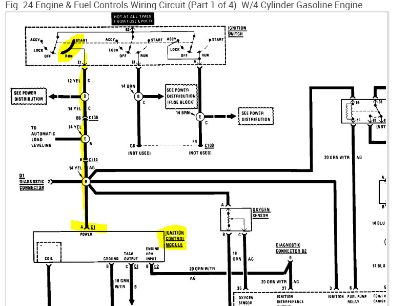

Okay, we need to check if power to the ignition control module (ICM) is present when the key is in the run position. I attached the schematic below. I need you to locate the ICM on the right side of the engine compartment. The coil will be mounted to it.
Once you locate the module, there will be a yellow wire going to it. With the key in the start or run position, that wire should have power.
Check this and let me know what you find.

There is power there at the yellow wire when the key is in the run position.

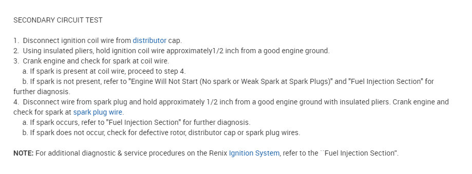

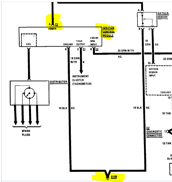

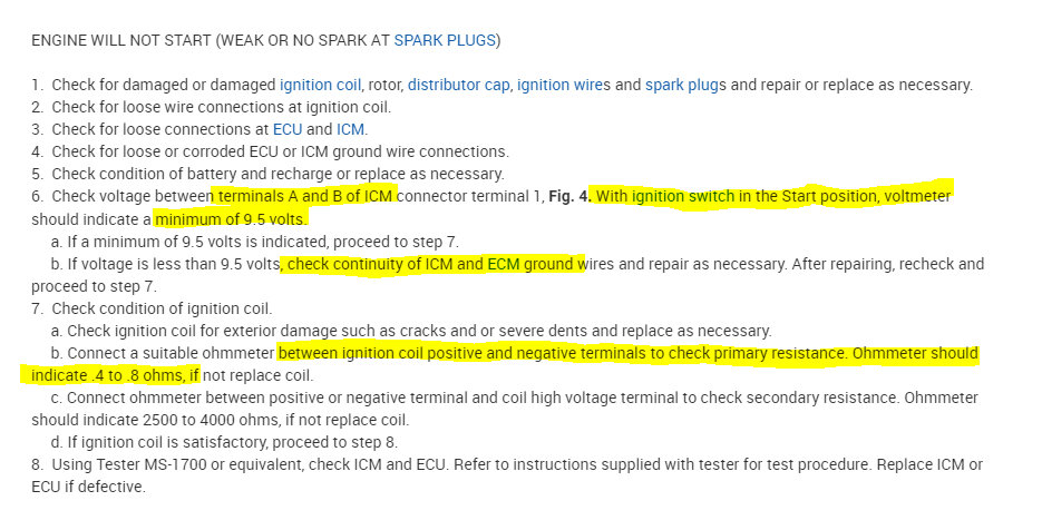

Was power present if the key was in the start position? Let me know. Another tech reminded me of the old-style ballast resister. What you experience is textbook when one would fail. I went through two different manuals hoping to find one on this vehicle with no success. Do you physically see one on the firewall or engine compartment?
I suspect that we have a faulty ground for the ICM, a faulty ICM, or a faulty ECM. I attached further diagnostics below for testing the ICM. Let me know if you are comfortable performing them. Note the last step requires a very old-style scan tool. Chances are you won't find one, but let's get to that point.
See pic below.

yes, voltage in start and run positions. I took an ICM off another truck I have that is known to be good and the same situation. No ballast resistor on this vehicle. I do have two 1989 Comanche trucks with the same engine and throttle body engines both ran when parked. Will the computer off these trucks work?

terminal B to ground has continuity.

If we have power and ground, it sounds like the ICM isn't getting an ignition signal from the ECM.
See if the ECMs from the donor vehicles have the same part number, and connectors, or if anything appears to be physically different. If it isn't compatible, chances are it simply won't start.
Sorry, the wiring schematics I have due to the model year are really difficult to follow and extremely vague.
