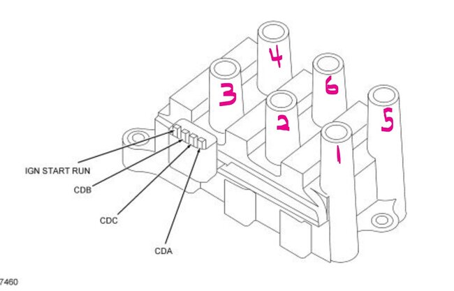

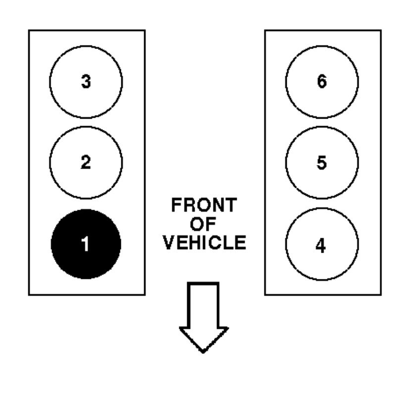

Spark plugs wire schematic needed?
2004 FORD RANGER
158,106 MILES • 3.0L • 6 CYL • 2WD • MANUAL
SALLYMANDERMATIC
MEMBER
2 POSTS
Wiring diagram for spark plugs.
Feb 26, 2023 at 6:51 AM
STEVE W.
Experienced Mechanic
15,409 POSTS
This is the cylinder locations and the plug wire locations on the coil. Be sure where the electrical connector is.

Thanks for helping me solve my issue today.
