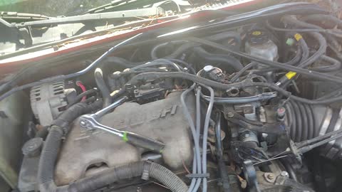

The spark plugs wire I. The back are stuck and need help getting them off.

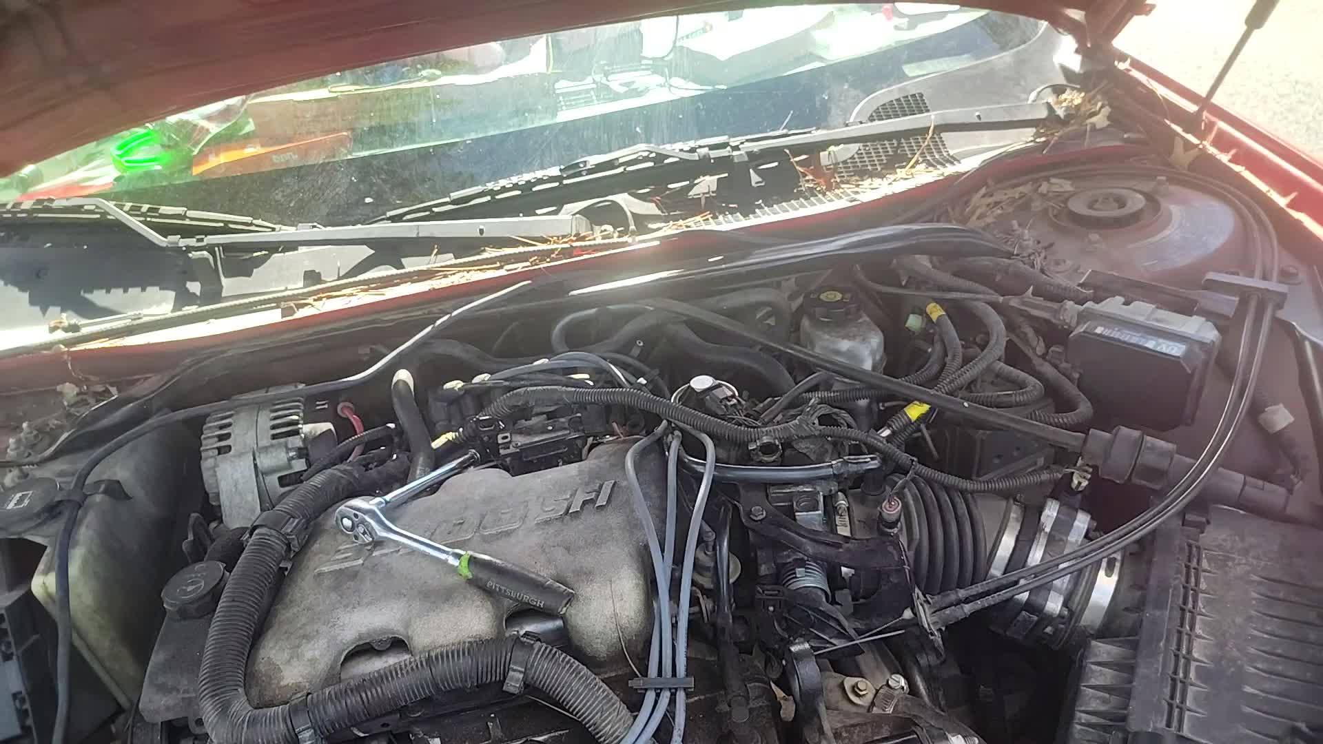

Yeah here I'm sending you a video right now of exactly what I'm trying to do.

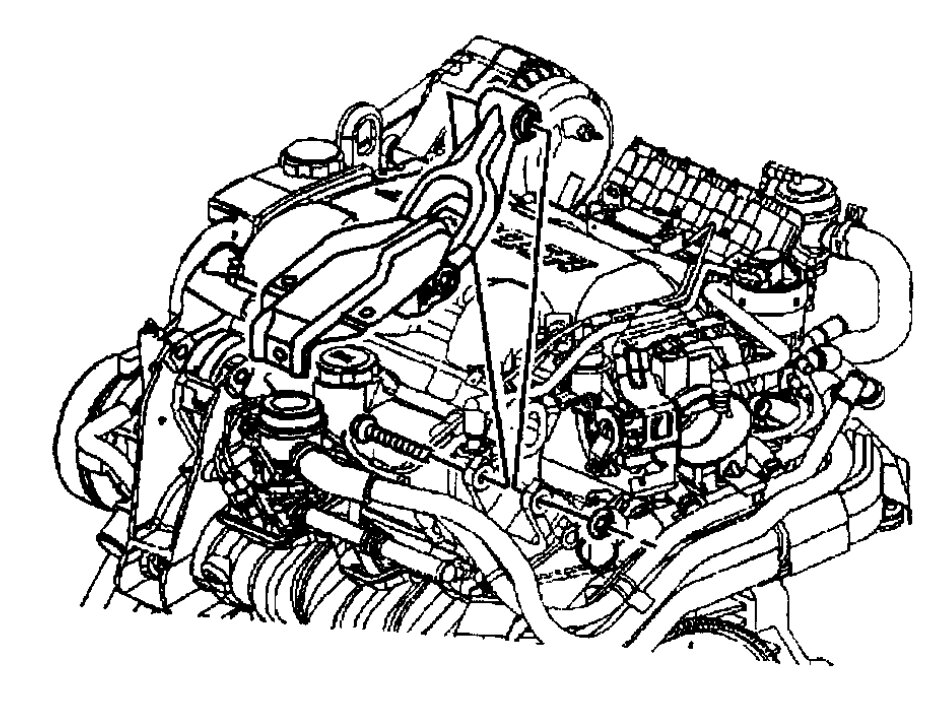

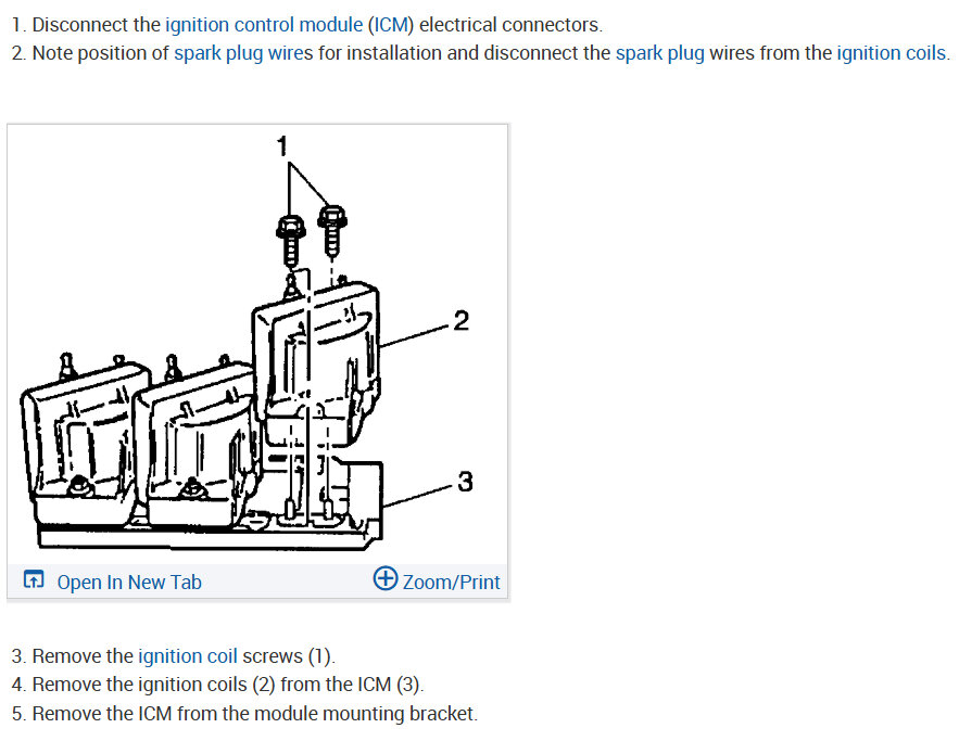

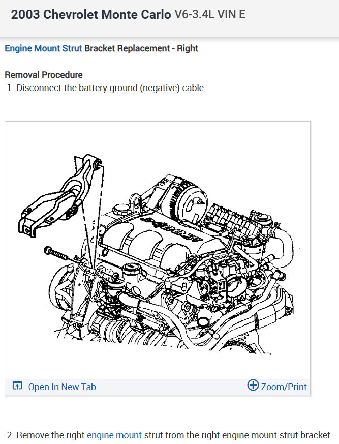

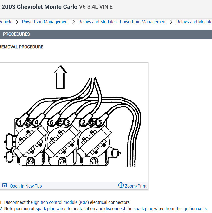

Yep, that is tough to get to. I would remove the ignition coils and I would remove the engine torque mount, (do not start engine) then while in park push the car forward a few inches which will cause the engine to roll to the front of the engine bay so you can get your hands back there, here is how. Check out the images (below). Let us know how it goes.
