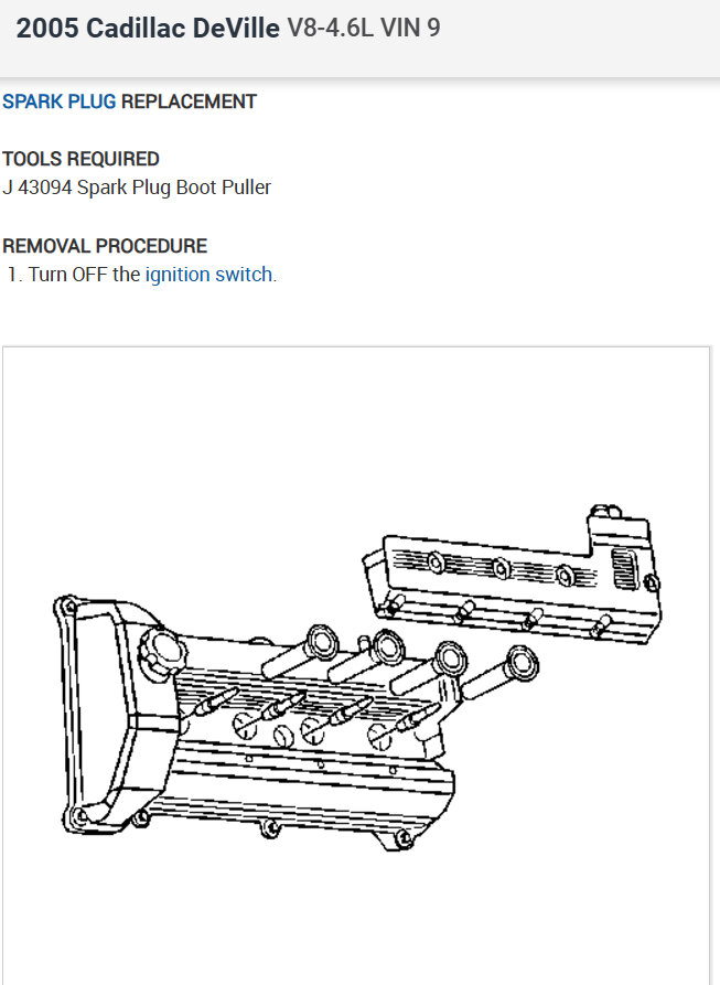

Could you tell me how to replace my spark plugs in my car listed above? thank you
Nov 20, 2024 at 3:51 AM
  • 55,433 POSTS

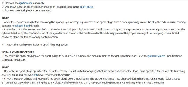

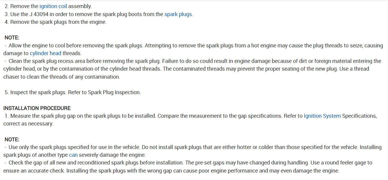

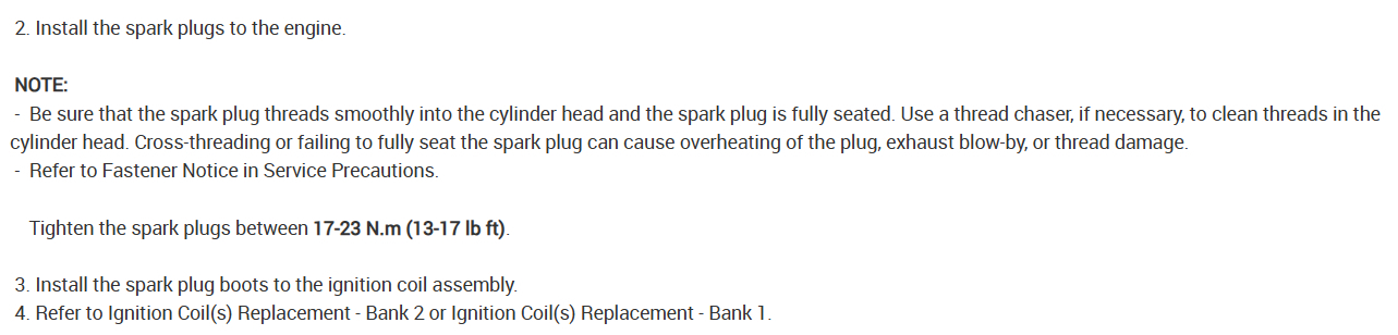

Sure, this guide can help walk you through the steps with instructions on what needs to be done step by step:
https://www.2carpros.com/articles/how-to-change-spark-plugs
Spark Plug Type .................... GM 12571535
Check out the images (below). Please upload pictures or videos in your response of any problems so we can see what to help you with.
