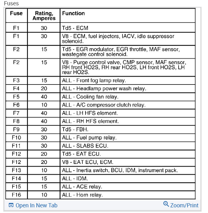

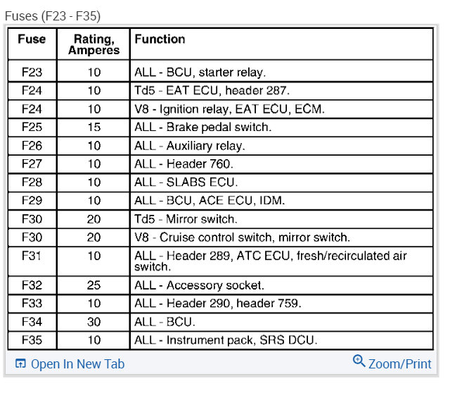

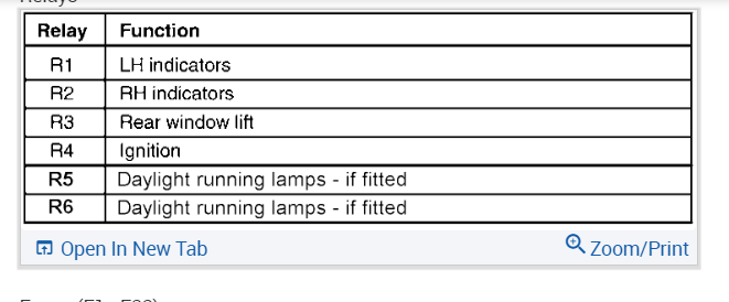

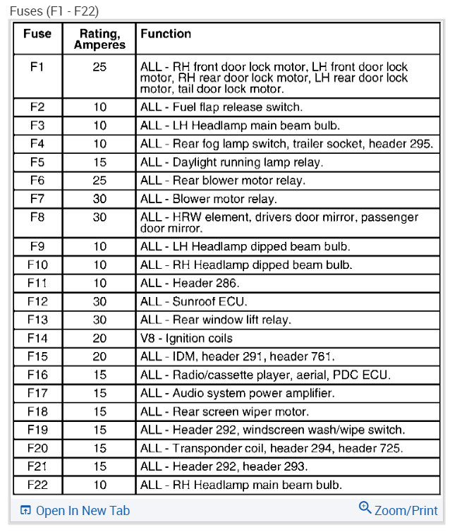

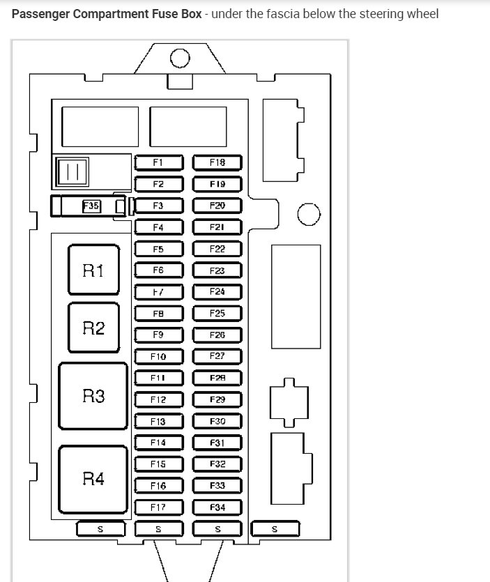

The engine cranks but there is no voltage going to the ignition coil not even to spark plugs.
Dec 4, 2019 at 8:02 PM
Experienced Mechanic
55,721 POSTS

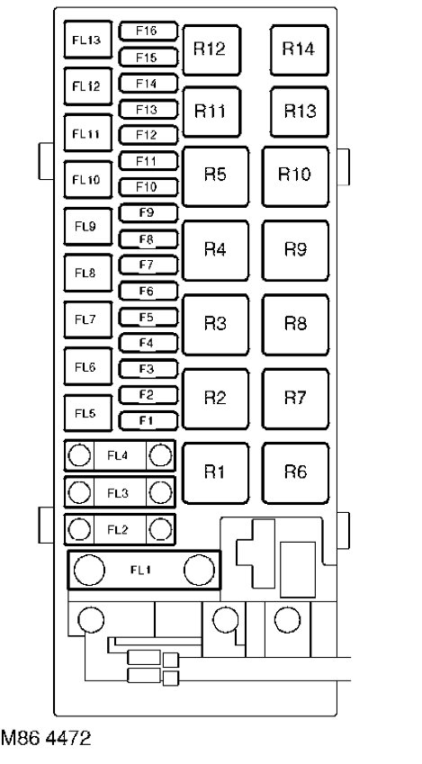

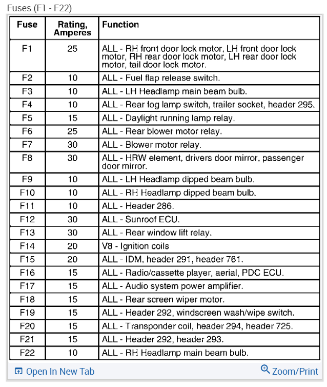

There is an ignition coil relay we need to check. here is a guide and the relay location so you can see whats going on:
Here is the fuse panel location and identifications. Please test with the key on.
