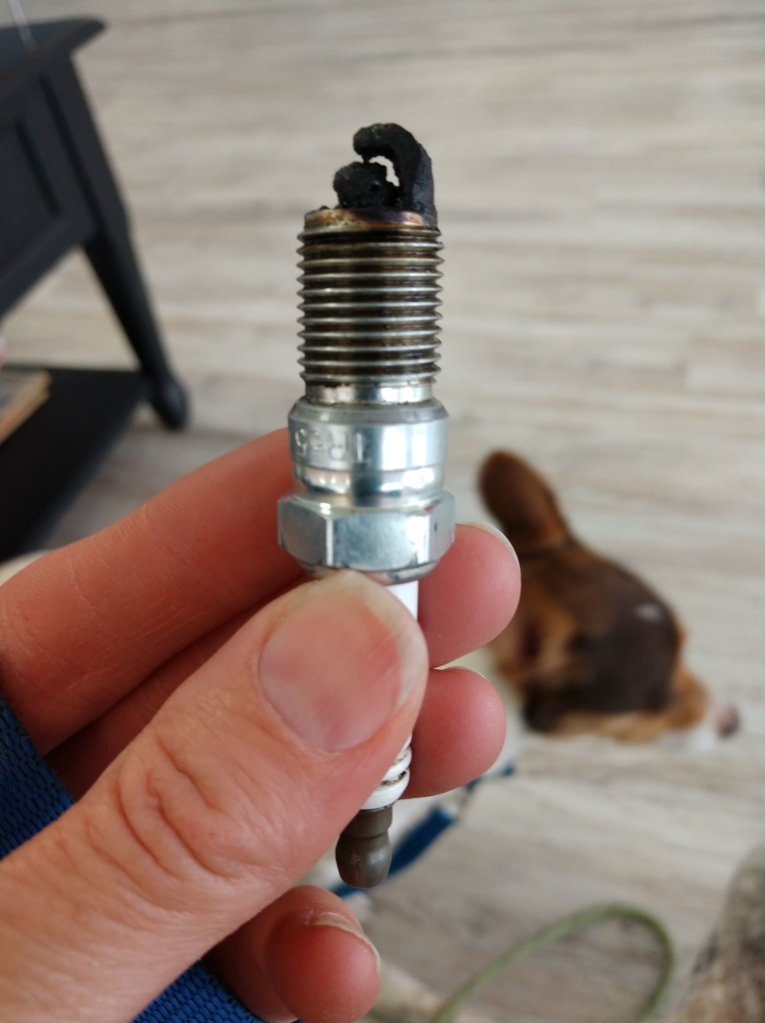

Hello!
This question is in regard to a 2006 GMC Sierra 2500HD (8.1L gas engine) with 197,000 miles on it. It had around 60,000 or 70,000 miles when I bought it in 2012. It has had a rough life since then - lots of hauling and towing. It has had a long-running problem of burning oil (I would have to add some oil every month), but the oil-burning has suddenly gotten much worse, and I am adding oil every few days. Every mechanic I've ever taken the truck to always says "that's just what old trucks do, they burn oil". Another problem (which I assume is related) is that the spark plugs get ruined frequently and have to be changed. I've had to change them at 124k miles, 130k (wires only), 170,000, 183,000, and 197,000. At 197,000 I told the mechanic I was tired of spending so much on spark plugs, and we decided to try a cheaper plug and see what happens. This, in addition to a full tune-up/fluid exchanges, fixed the symptoms I was seeing (intermittent shudder when idling, 'check engine' light coming on when going uphill over 45 mph, engine misfire code P0300). But then I only made it 1200 miles before those same symptoms returned. Same P0300 code, one ruined spark plug, cylinder 2. A mechanic replaced that one plug, and I made it another 80 miles before things went south again yesterday. This time it's 2 plugs, cylinder 2 and another cylinder (he didn't tell me which one). So we're replacing all plugs with the better double platinum ones. Any ideas what is going on? Am I just doomed to replace the plugs every 15,000, miles from now on? I love this truck and don't want to get rid of it. For anyone interested, there are more details below, in case they provide any additional clues. Thanks in advance!
- oil changes are done every 5,000 miles
- oil cooler lines replaced in 2013
- major tune-up at 124,000 miles (transmission flush, coolant flush, 4x4 service (front/rear differentials, transfer case), spark plugs, fuel induction system service, air filter replaced)
- at 130k, replaced spark plug wires, cleaned mass air flow sensor
- at 132k, replaced fuel pump assembly
- at 169k, code P0171, cleaned mass air flow sensor
- at 170k, replaced spark plugs, plug wires (mechanic said plugs were really bad and covered in oil)
- at 174k, replaced air filter
- at 183k, replaced spark plugs and air filter
- at 1955xx miles, replaced serpentine belt, belt tensioner, and fan clutch; mechanic said spark plugs are misfiring/worn out (but I couldn't afford to replace them yet); mechanic said "we took off the valve covers and looked inside of the cylinder heads, in case the valves are gummed up. But we didn't really find anything except the piston rings are a bit burned out." He recommended trying Lucas oil stabilizer and Lucas fuel cleaner (which I did) and using premium gas and higher quality synthetic oil from now on (which I did). He said the engine is burning lean, so better fuel will help that. Told me to get a tune-up as soon as I can.
- at 197,000, 'check engine' light came on every time going uphill over 45 mph; code was P0300 (engine misfire; no other codes); idle is very rough; replaced spark plugs/wires with cheaper copper plugs as an experiment, did fuel exchanges (differentials, transfer case, transmission (& filter), coolant, power steering fluid); cleaned the air filter
- 1200 miles later, replaced 1 spark plug; added "Engine Restorer 8-Cylinder" to the oil, as recommended by the mechanic
- 80 miles later (today), replacing all spark plugs with the right kind. Mechanic says it will take a while of driving at high speeds for the "Engine Restorer" to work?
I travel a lot, so I rarely get to use the same mechanic. Whenever I go to a new mechanic, they usually tell me that my last mechanic was BS-ing me and/or didn't know what he was talking about. I'm a car dummy, so I have to just take the word of these mechanics, and I never really know when I'm getting the run-around.
Thanks to anyone who made it this far in my post!
(attached photo is the cheapo copper spark plug after 1200 miles)

Good morning,
With the mileage, I think it is normal for it to burn some oil. In order to fix that, you would most likely be talking a rebuild.
As far as the plugs. The first thing I would do is check the fuel pressure. It sounds like it is running lean and that could be from low fuel pressure. It will also cause the plugs to burn up like they are from the driving you do.
I would start there.
