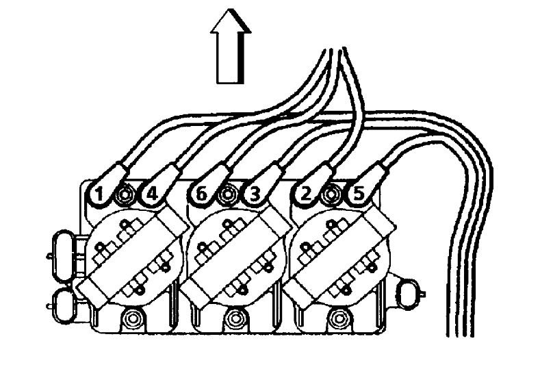

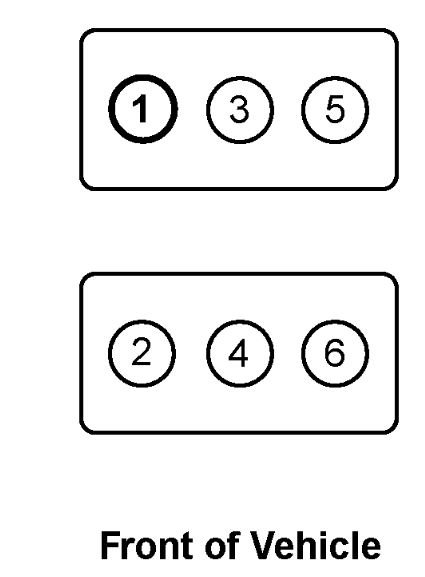

Need to no where in the back does the spark plugs and wires go on the caps. There round with two sets of numbers on top like 5;4 and 2;2. And so on. What number do I put my back plugs on. Then in front from left to right what number from the back goes to the front. If you have a diagram or could just tell me I would be very grateful. Thank you.

I attached two pictures for you to view. They have the coil arrangement and the wire positions. Check out the diagrams (Below). Please let us know if you need anything else to get the problem fixed.
