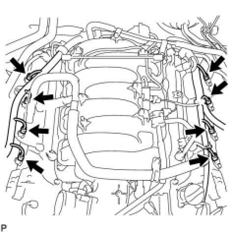

How do you get the coil out? It's the one on passenger side next to fire wall. Spark plugs and coil on passenger side.

Here are the directions for removal and replacement. Additionally, I added a link that discusses tune up and plug replacement.
https://www.2carpros.com/articles/how-to-tune-up-a-car-engine
REMOVAL
3UR-FE IGNITION: IGNITION COIL AND SPARK PLUG: REMOVAL
1. REMOVE V-BANK COVER SUB-ASSEMBLY See: Intake Manifold > Removal and Replacement > Removal
2. REMOVE AIR CLEANER HOSE ASSEMBLY See: Intake Manifold > Removal and Replacement > Removal
3. REMOVE AIR CLEANER ASSEMBLY See: Engine > Removal and Replacement > Removal
4. REMOVE IGNITION COIL ASSEMBLY
(a)Disconnect the 8 ignition coil connectors.
(b)Remove the 8 bolts and 8 ignition coils.
5. REMOVE SPARK PLUG
(a)Using a 16 mm plug wrench, remove the 8 spark plugs.

Installation is reverse of removal
