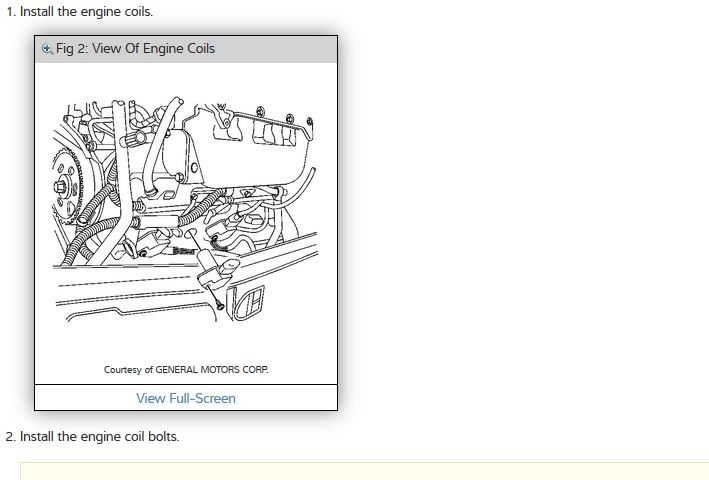

How to remove/install spark plugs on this engine? There are no videos anywhere. Can you help?
Mar 17, 2018 at 2:17 PM
HARRY P
  • 2,292 POSTS

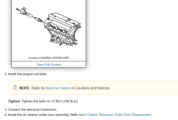

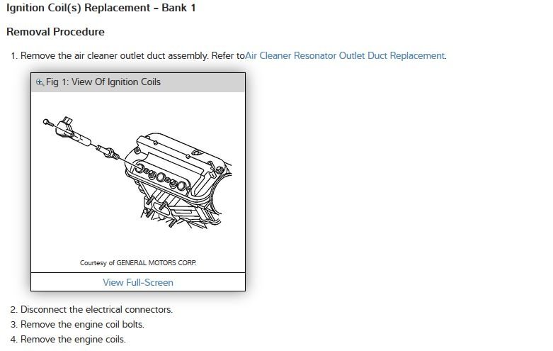

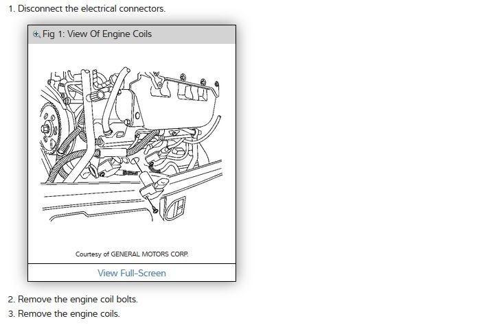

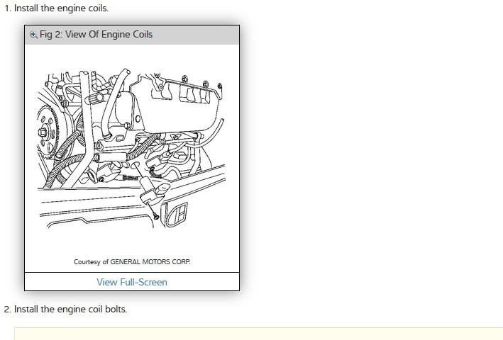

Well the instructions from Saturn are a bit simplistic. They say step (1) remove ignition coils. Step (2) remove spark plugs. Step (3) install new plugs. Step (4) install coils.
The instructions for removing the coils on Bank 1 (the front side) are in the images.

Bank 2:
