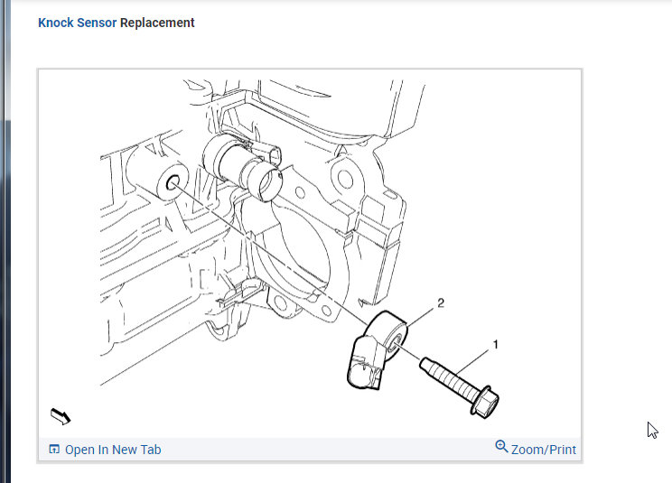

what could cause the tips of all 4 spark plugs to burn out too fast within 2,000 to 3,000 miles? The car runs with out the check engine light coming on , no codes found and no misfire.

it's not running too rich. the plugs were running clean, normal with the center electros burned completely off in a short time. No misfire or any other DTCs.

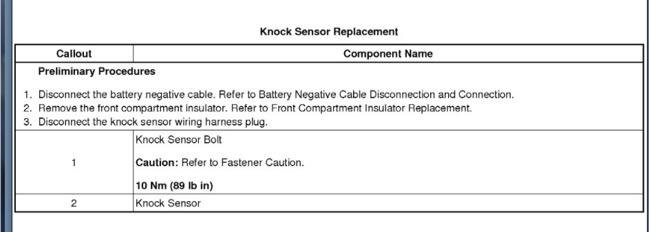

If the plugs look normal except the electrodes burned off then that is due to pre-ignition or detonation. Do you hear a pinging or marbles in a tin can when accelerating lightly?
If you have no codes then we may have an issue with the knock sensor. This is supposed to advance or retard the timing if it is knocking or detonating.
Also, you can run a couple cans of injector cleaner through the fuel and increase the octane for a couple tanks just to rule out a fuel issue.
https://www.2carpros.com/articles/how-a-knock-sensor-works
Are they all this way or just one cylinder each time?

all 4 cylinders in a short time. iridium AC Delco spark plugs.
Mar 24, 2021 at 1:37 PM
Okay. then you must have some serious detonation. Have you noticed any engine noise? Give the fuel treatments that I mention a try and see if that clears it up otherwise we are going to have to look into carbon build up or leaking injectors.
