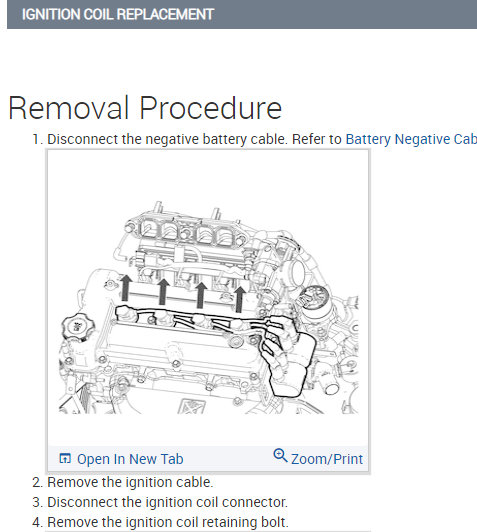

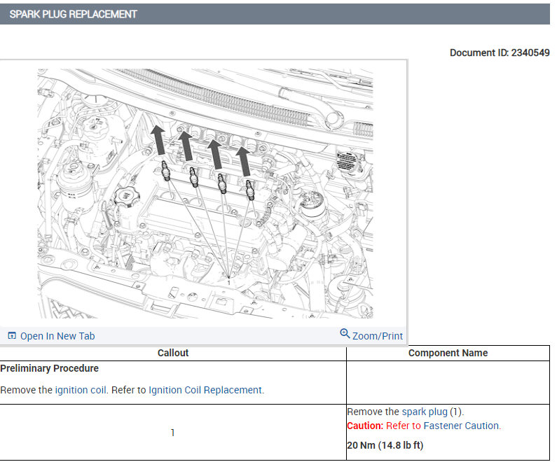

Hi, my car crank but won't start. I checked the spark plugs and they all wet with fuel. Please help!
Jul 14, 2021 at 3:33 AM
SQM
  • 6,383 POSTS

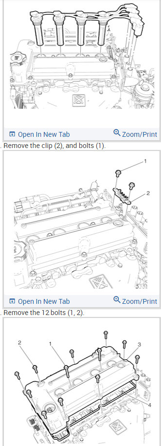

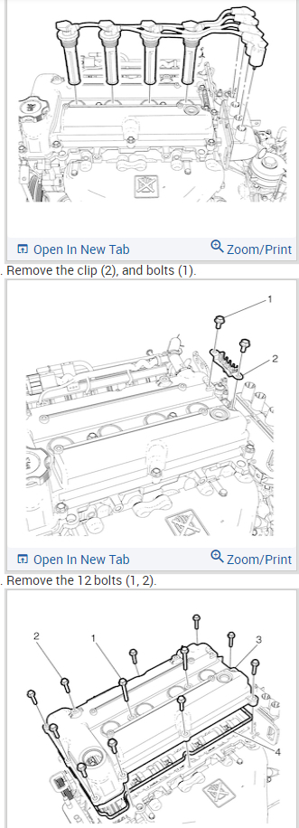

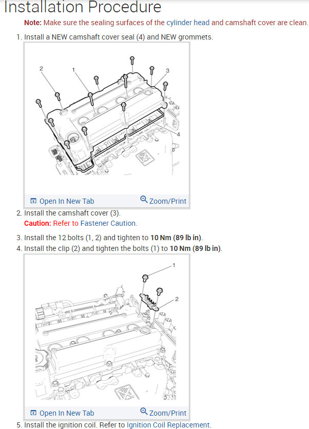

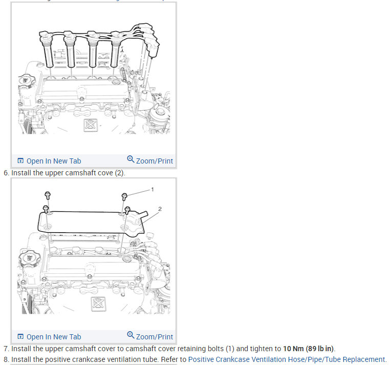

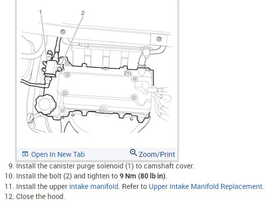

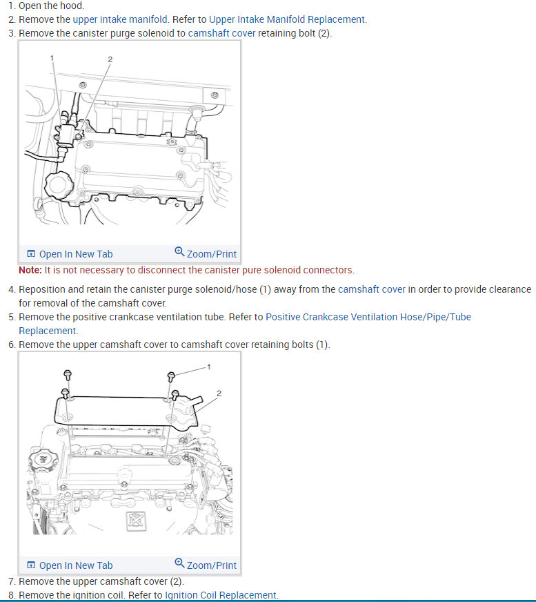

You probably have oil in the spark plugs. Is the spark plug covered with "dark" fluid?
Usually if there is a leak in the valve cover gasket, oil can leak into the plugs.
Are there any trouble codes?
https://youtu.be/ahK_eucFi-k
Here is an article you might find helpful:
https://www.2carpros.com/articles/how-to-tune-up-a-car-engine
https://youtu.be/9M6xWMMRe0E
I have attached spark plug replacement as well and valve cover gasket replacement.
Let me know if you have any questions.
