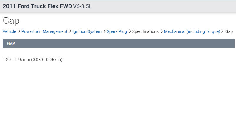

Proper spark plug gap, I’m getting three different gap sizes searching online. Do you know the proper spark plug gap?

The spark plug gap should be 1.29 - 1.45 mm (0.050 - 0.057 in).
Let me know of any questions. Check out the images (below). Let us know if you need anything else. Thank you.
Image (Click to enlarge)
