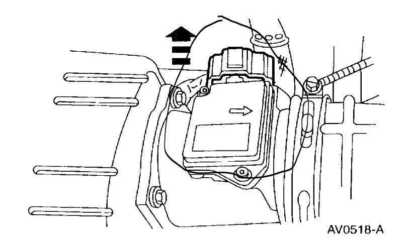

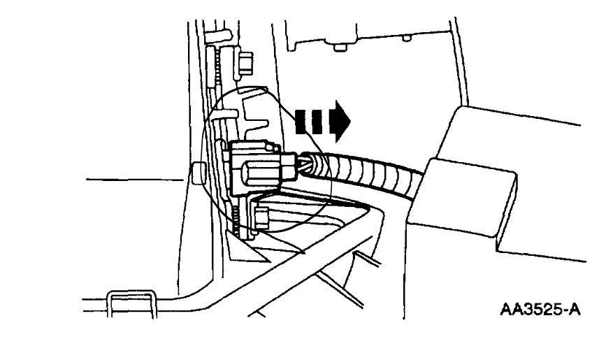

First, the oil leaking isn't actually into the cylinder. He may have confused you. What happens is the o-ring that seals the spark plug tower can leak allowing oil to enter the tower. That can eventually lead to a misfire.
The codes you have could be related to the hesitation. The P0102 is related to the mass air flow sensor (MAF). Some basic things you can check is to first make sure it is connected. Also, check to make sure there are no air leaks near it.
The other code, P0113 is related to the intake air temperature sensor (IAT). Interestingly both of these components are near each other and work together. So again, check to make sure it is securely plugged in and there are damaged wires going to it.
I attached two pics. The first shows the MAF. It is mounted on the air inlet tube (between the air filter box and intake manifold). The second pic shows the IAT. It is on the side of the air filter box.
Let me know what you find. I believe it is one of these two that are causing the hesitation.

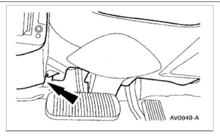

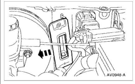

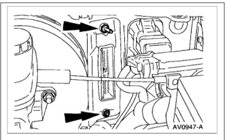

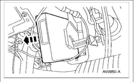

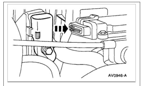

It sounds like the coil drivers inside the PCM are bad I would get a used one and swap it out. Below is the location.

It could be but only a re-builder can tell you that. When you switched the PCM the security light flashed?

Not really because the ring is just the antenna which delivers the chip frequency to the computer key. This is why the car must go to someone that can program the key in. Should cost about $130.00
