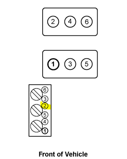

Where is the wire connection for the number 2 plug?
1999 BUICK PARK AVENUE
140,000 MILES • TURBO
BOB BRYANT
I only find 1,3,4,5,6.
Jul 5, 2023 at 12:14 PM
  • 110,244 POSTS
I believe you are referring to the spark plug wires. Is that correct? If so, I attached a picture below showing the cylinder orientation and the ignition coils and the order of the spark plug wires attached to it.
Let me know if this is what you are referring to.
joe
See pic below.
