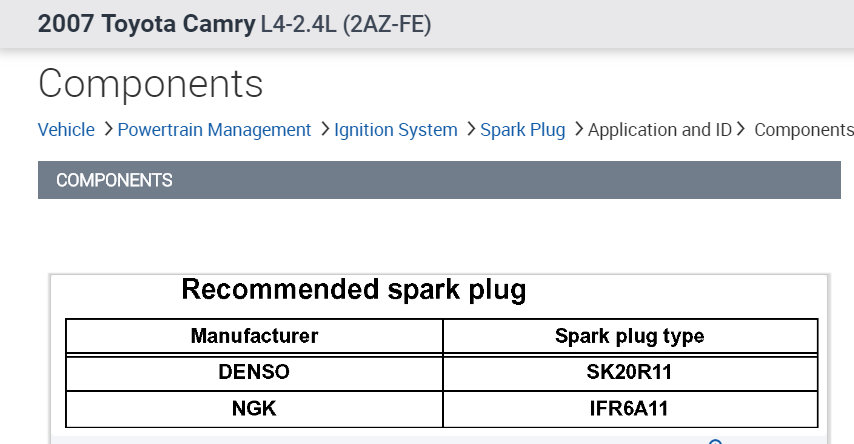

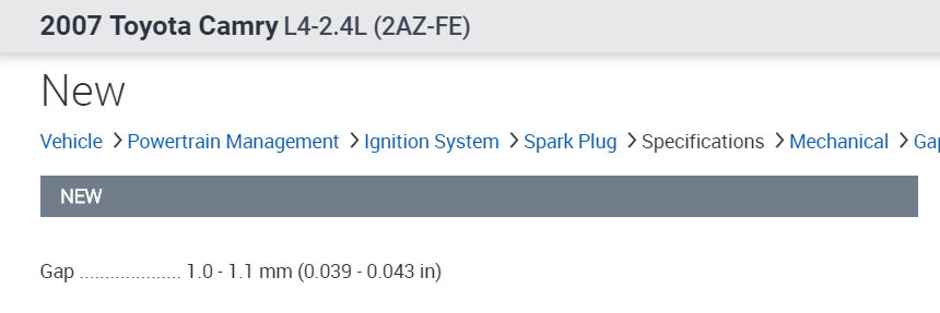

What are the OEM on spark plugs?
Aug 1, 2019 at 8:53 PM
SCGRANTURISMO
  • 4,897 POSTS
I have included the information that you requested in the diagrams down below. I hope this helps, as there are two different choices available to you, both of them are recommended by the vehicle manufacturer. Please let us know if you have any other vehicle related questions. We are here to help.
