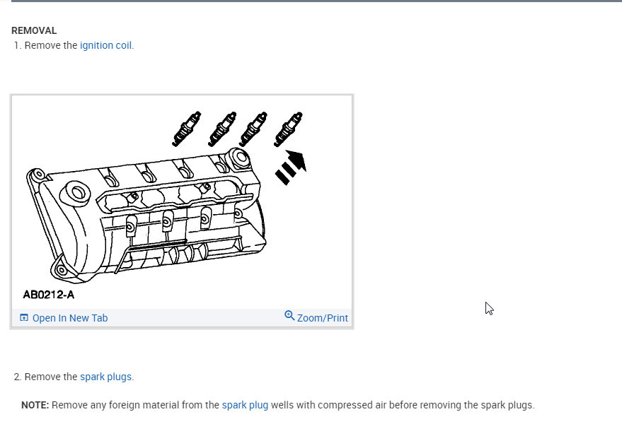

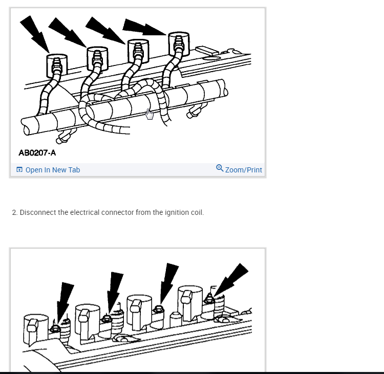

How do I change the spark plugs? I'm having trouble even locating where they are.
Sep 10, 2019 at 9:11 AM

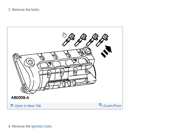

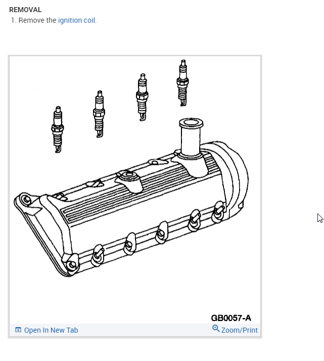

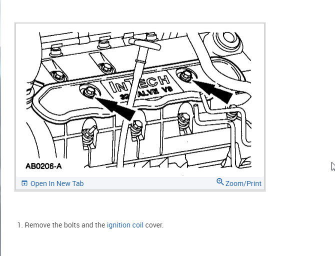

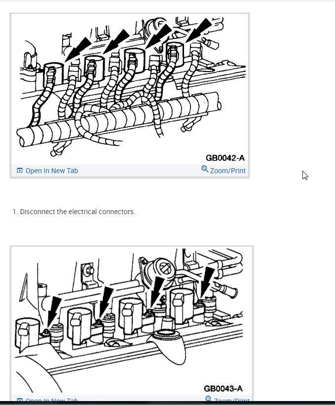

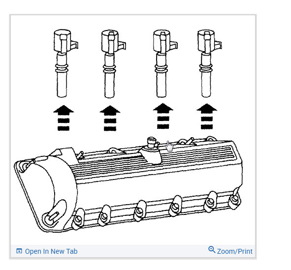

Here is the procedure for removing them. The first 4 screen shots show for the dual overhead cam engine (DOHC) and the next 3 are for the single overhead cam (SOHC) engine.
In both cases, you need to remove the coil on plug in order to access the plugs. I suspect you have the DOHC engine because it has a coil cover that you need to remove in order to gain access.
Let me know if you have questions and we can go from there. Thanks
