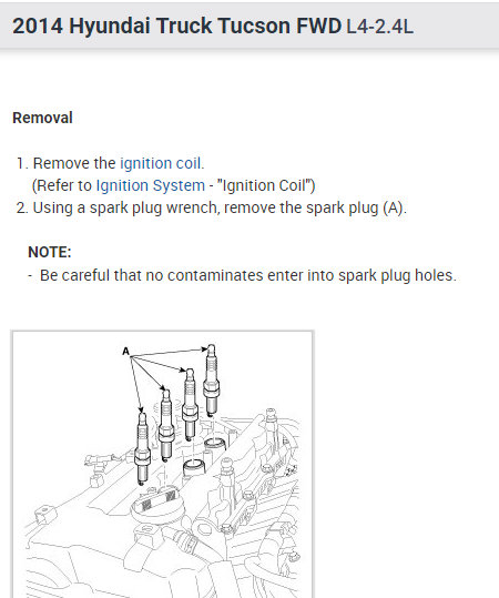

What is the recommended spark plug for the vehicle listed above?
Jan 29, 2021 at 5:25 AM
DANNY L
  • 5,648 POSTS
Hello, I'm Danny.

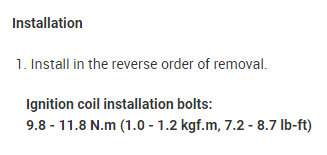

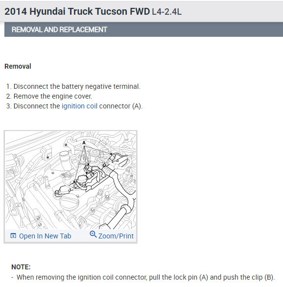

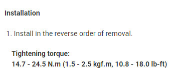

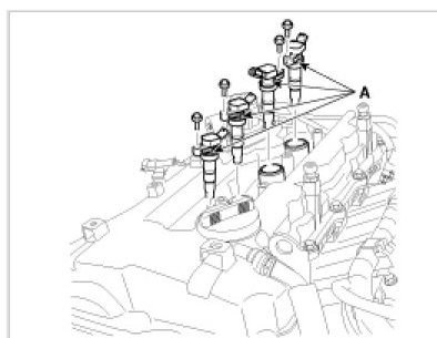

Here is the information you requested. Here is a tutorial for you to view showing how to replace spark plugs:
https://www.2carpros.com/articles/how-to-change-spark-plugs
I've attached pictures below showing the recommended spark plugs as well as how to remove and replace. Hope this helps and thanks for using 2CarPros.

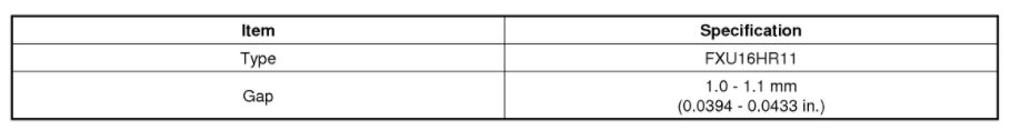

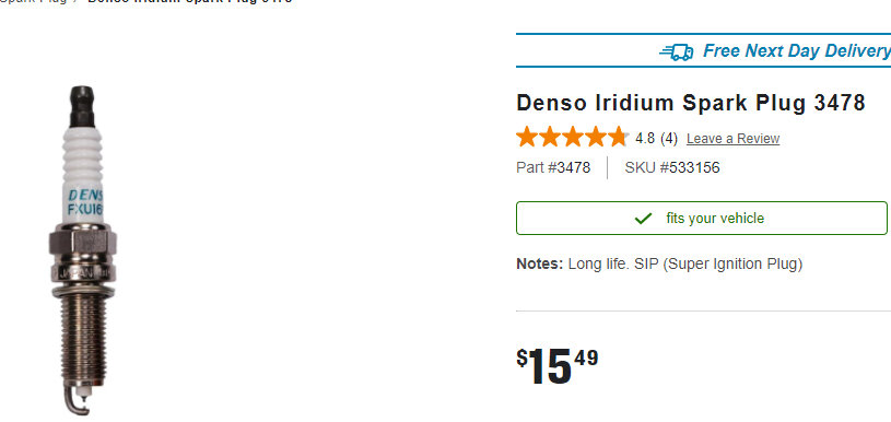

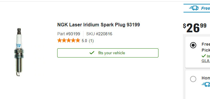

I need to know the recommended spark plug to use.
Jan 29, 2021 at 8:23 AM
DANNY L
  • 5,648 POSTS
Hello again.
The part number I gave you is the Denso brand spark plug from our reference guides. Hyundai also recommends the NGK brand as well. I've attached their pictures below with the corresponding part numbers. Hope this helps and thanks again for using 2Carpros.
