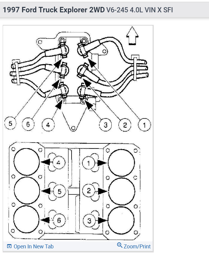

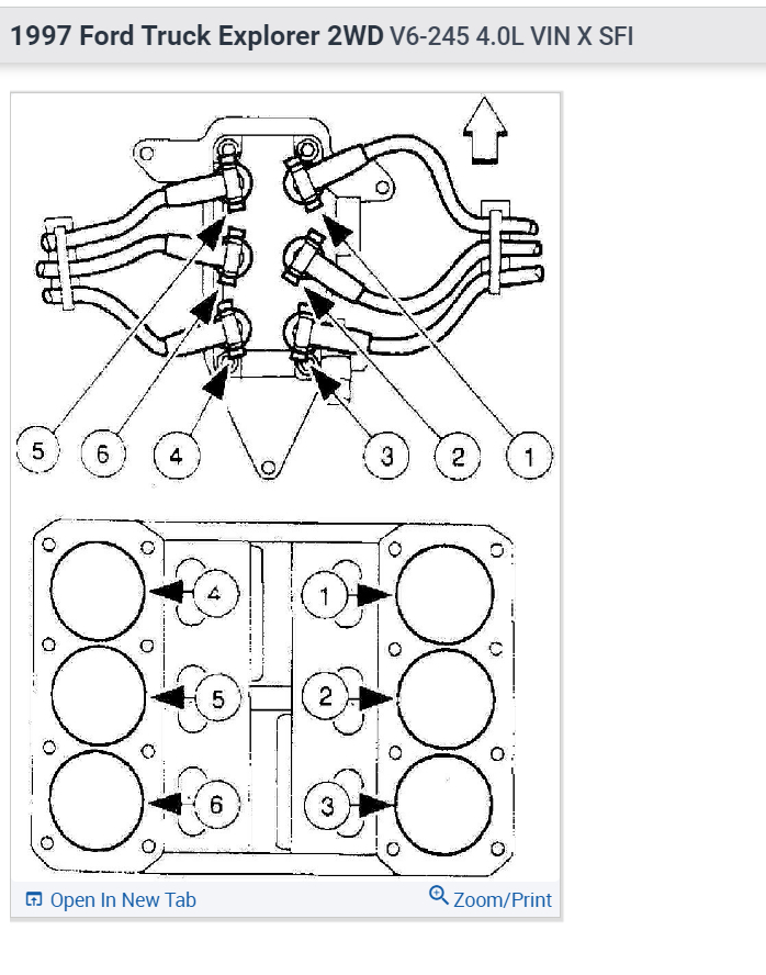

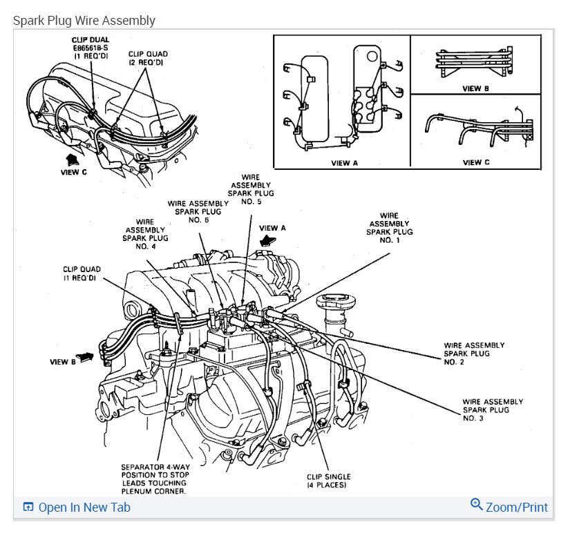

So, I recently changed the spark plugs and the spark plug wires, but I believe I connected the spark plug wires incorrectly. Can you please help me with the diagram or tell me where each wire goes? Please and thank you.
Apr 12, 2023 at 5:59 PM
  • 55,423 POSTS
Sure, here is the firing order and how the spark plug wires should be installed in the images below. Please let us know if you need anything else to get the problem fixed.
