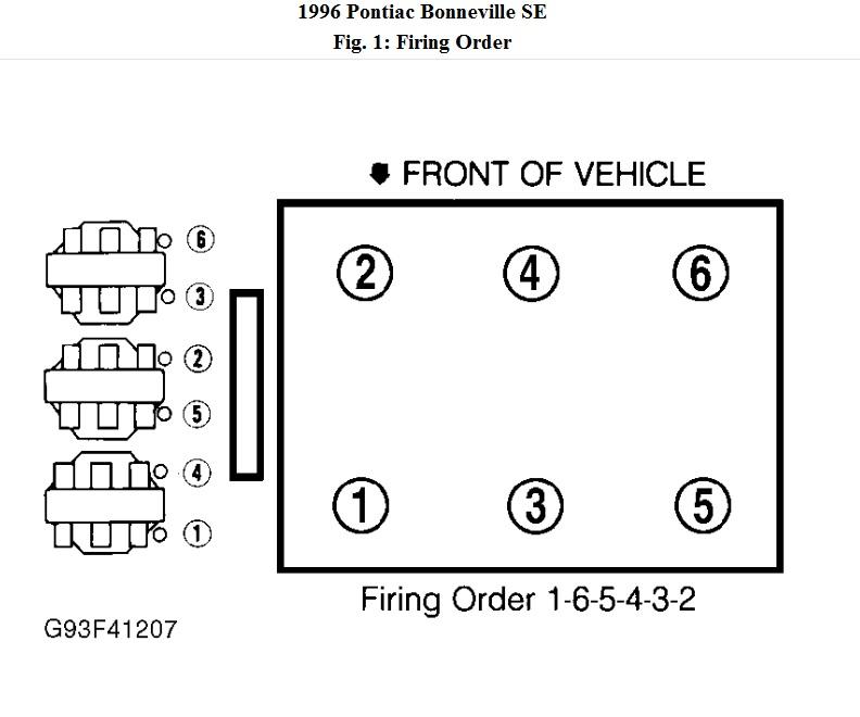

I have miss routed my plug wires. can you show me a diagram of the wire routing along with the firing order. my car is not running. I have replaced the coil packs and ignition module. I got a bad ohm reading from my wires so I called myself labeling and pulling them. I screwed up on that somewhere. also, the plugs were fuel saturated when I pulled them. the diagram would be a good start if you would show me that. thank you.

Hope this helps.

it does, thanks.
