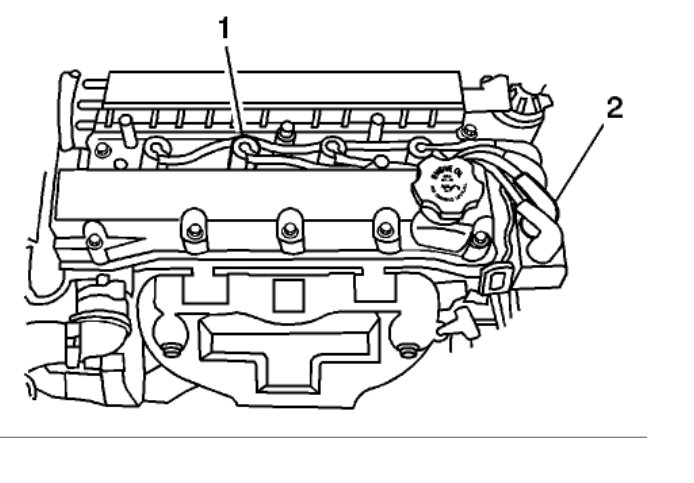

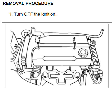

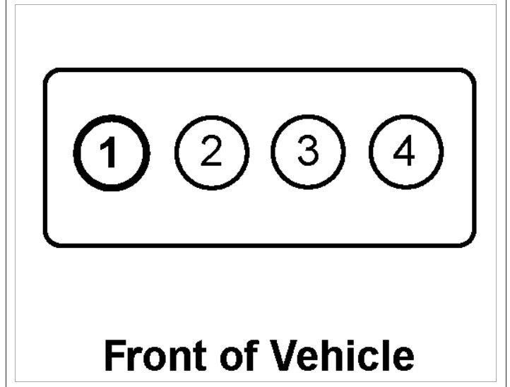

Spark plug wires were removed and not sure of firing order they go.
Jan 2, 2018 at 12:02 AM
Experienced Mechanic
55,758 POSTS
Here is the firing order:
Firing order 1-3-4-2.
