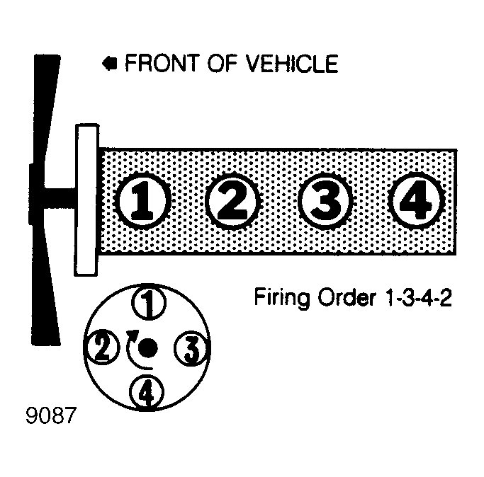

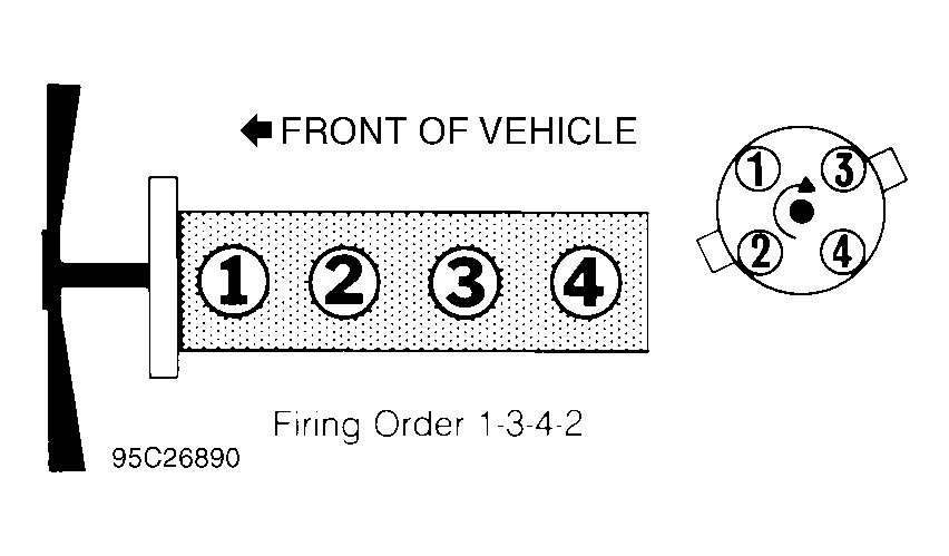

Plug wires were changed last year when we got the jeep. Along with distributor cap rotor and plugs. We followed the same pattern that was there. It has always had a slight hesitation and has cut off at idle off and on. Going to change everything again and now have the manual for it. It shows however, the diagram for our vehicle is not the pattern we have on the distributor, but the one for up to a 1987-1991? Could this be why it has never run 100%?
Thanks in advance.

So which is the right one? It is a 1995, but the wires on the Jeep are the same as the 1987-1991 diagram. I am kind of confused.

Here is what your diagram should be for a 1995. I am pulling up the other one in a second for comparison.

HARRY P
  • 2,292 POSTS
This is for a 1991. It is basically the same, just with the distributor in a different location (which has no effect on performance). The actual firing order and direction that the distributor turns is the same.
So basically, either diagram would get the job done for you.
