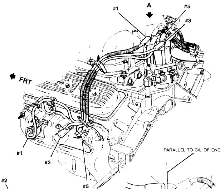

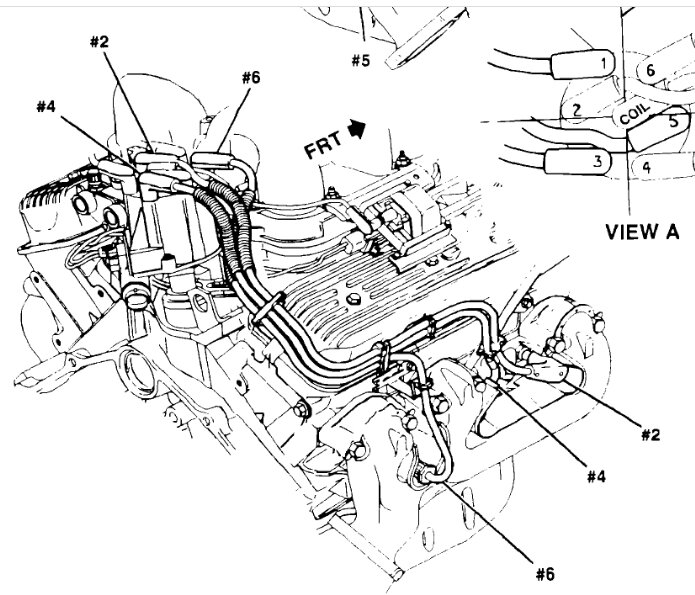

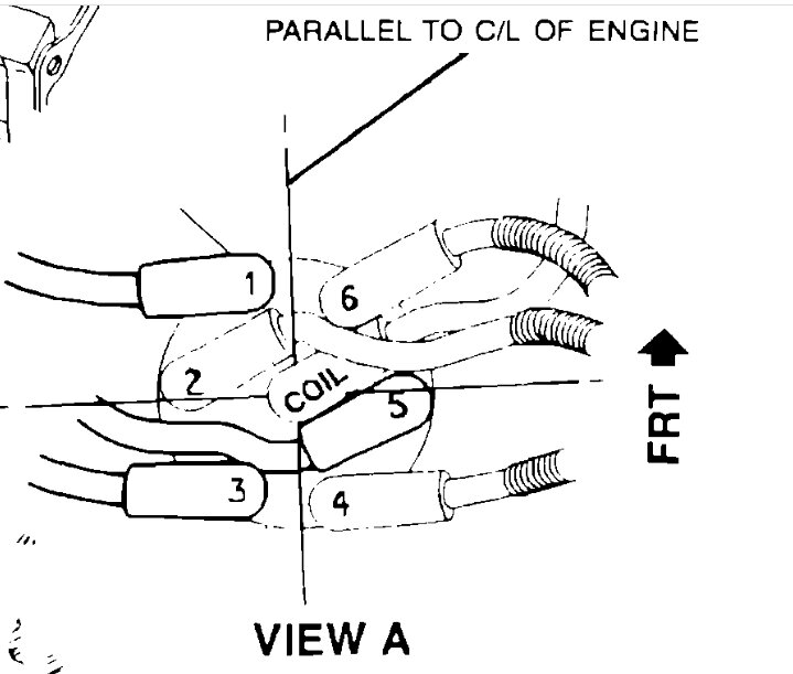

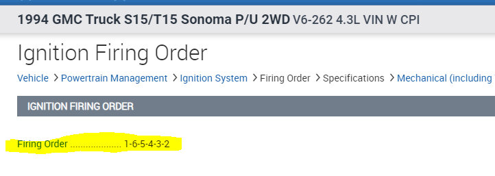

How to install the spark plug wires?
1994 GMC SONOMA
280,000 MILES • 4.3L • V6
SAM78
Need help putting them on.
Aug 6, 2023 at 10:21 AM
  • 110,244 POSTS
First, I attached a pic below providing the engine firing order. See pic 1.
The remaining pictures show how the wires are placed on the distributor cap based on cylinder and how to route each wire to the correct cylinder.
Let me know if this helps or if you have questions.
