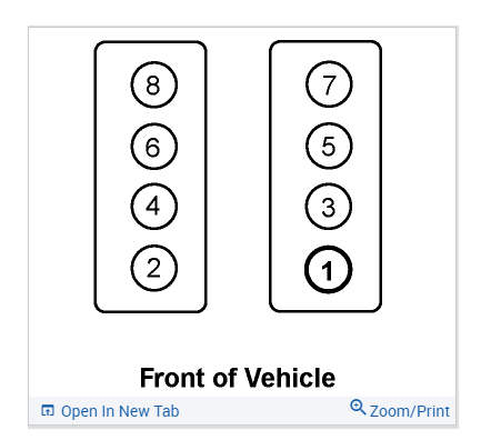

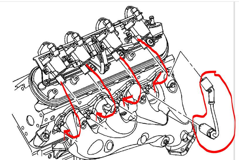

I mixed up my spark plug wires. No idea what goes where, what should i do ?
Apr 15, 2023 at 2:25 PM
  • 110,240 POSTS
I'm not sure what you mixed up. Each cylinder has a coil pack and the wire from the coil goes to the spark plug which is below that coil. See pic 1 below
Do you mean you mixed up the connectors to the coils?
I attached a pic below showing cylinder locations if needed as well (pic 2).
Let me know if this helps or if I'm not understanding.
