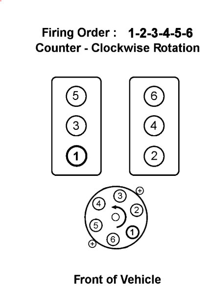

Spark plug wires diagram and firing order needed?
2001 NISSAN FRONTIER
315,000 MILES • 3.3L • V6 • 4WD • AUTOMATIC
FWAYBS
Firing order for spark plugs and a diagram for spark plug wire placement from distributor to the spark plugs.
Dec 7, 2024 at 1:47 PM
  • 110,194 POSTS
I don't have a diagram for routing the wires. Just try your best to prevent them from crossing each other and keep them away from excessive heat sources such as an exhaust manifold.
On the other hand, I am able to provide the firing order and the wire locations on the distributor. See pic below.
