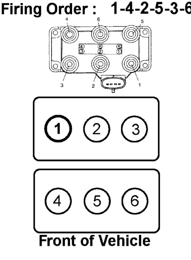

I want to know how does the spark plug wire goes to but not into the engine but distributor.

Yep we got you covered, here is the firing order you need to get the car running again. (below)
