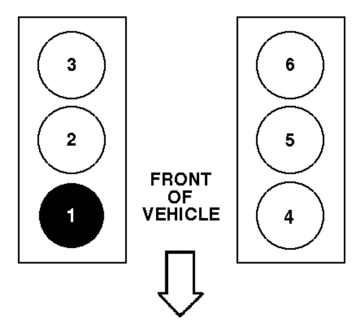

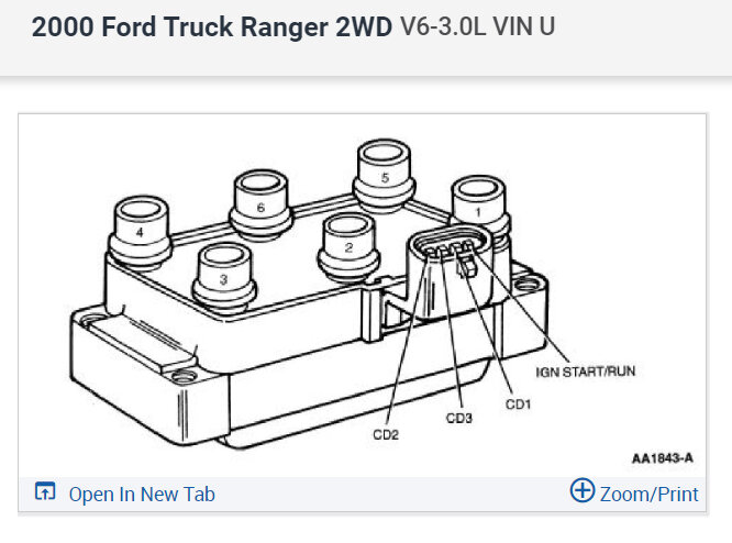

I'm trying to find the proper pattern for my spark plug wires from the ignition coil to the spark plugs?
Sep 13, 2024 at 7:45 AM
Experienced Mechanic
55,694 POSTS
There is a 3.0 liter, and 4.0-liter engine here is the firing orders for both. cover our bases :)
Here is the 4.0 liter, check the image below for the cylinder ID:
V6 Firing Order: 1 4 2 5 3 6
Here is the 3.0 liter
Firing order: 1-4-2-5-3-6
Looks like they are the same. Check out the images (below). Let us know if you need anything else.
