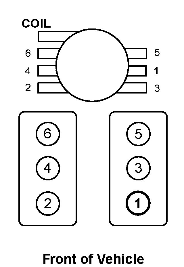

I change the spark plug wires and spark plugs and now i got a misfire. Spark plug wire diagram needed.

Hello there. I'm attaching the image that I think you need. Hopefully this gets you going again.
Tip: the best way to avoid this situation when doing spark plugs and wires is simply do do it one cylinder at a time. This helps you too keep things organized and straight while avoiding confusion.
Good luck and let us know if this helps out if you need more help with your truck.
