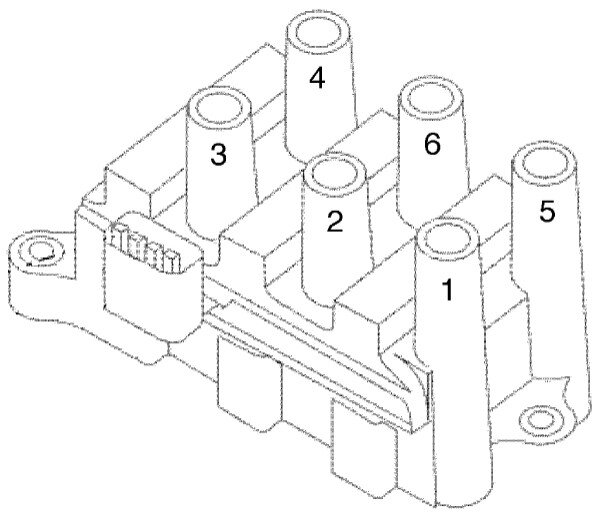

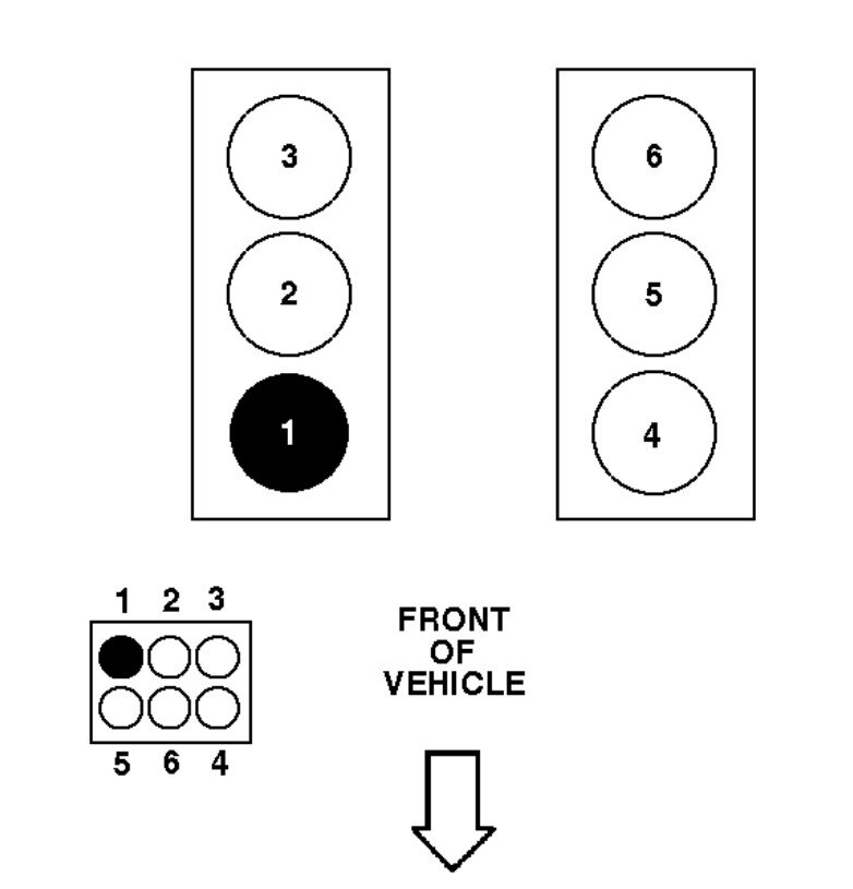

I need a spark plug wire arrangement.
Jun 11, 2024 at 5:20 PM
STEVE W.
  • 15,239 POSTS
This should be the cylinder layout and the coil pack for that engine. It uses a waste spark system that fires 2 cylinders at the same time, one cylinder would be firing, and one will be on exhaust. So, it fires cylinders 1 and 5, 2 and 6 and 3 and 4 as pairs.
