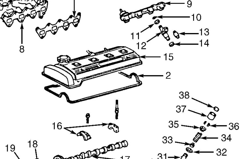

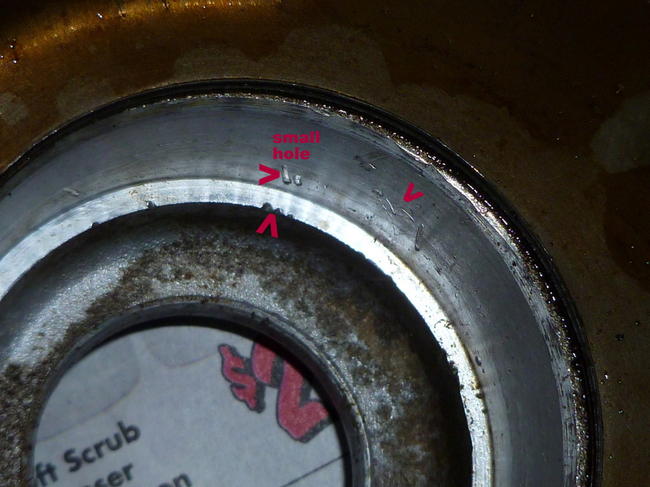

Hi. Doing my first valve cover gasket. Removing the old seals left some scratches and at least one small hole where metal was shaved off. I don't trust it not to leak. What can I use to seal the spot that is safe for the engine/sensors? Also whatever I use should I let it dry before I install the seal because I am expecting it to need some oil or something to help slide it into place with my DIY bolt-washers press? I already have Ultra Grey RTV and some 3M super weatherstripping glue that I'm not sure is safe and leak/temp proof. Also I need a good, large photo of where to put the RTV on the head. The one in Haynes is too small to be useful. Thank you. Using Fel Pro PermaDry set.
Oh one more thing. I'm nervous about the torquing so I planned to under torque to say 35 in-lbs to make sure I don't bust something and then drive it straight to a shop (5 miles) and have them check and torque it properly. Is this something I can get away with safety-wise and will they charge me to do so? (I have a rented torque wrench and no way of checking it's accuracy). Thanks again.

Hi. I guess you were responding to the picture portion of my question. Haynes says there are 5 or 6 areas on the head edges where I am required to put RTV to prevent leaks like around the cams? Or something I think. This is whether or not you use something on the gasket itself. Thank you for the coating info.
I don't know if this is the only response I'm going to get so I better say most of my question still needs to be answered.
Sealing leak paths for the spark plug tube seals. How and what product to use.
Apply sealant on aluminum walls where the seals installs, dry sealant then coat seal with oil and press in. Or just coat seal with sealant, press in and dry.
RTV application photo.
My torquing plan.
Thanks a lot,
Chris

Hi. Thank you so much for your answer. My very specific questions are about installing the spark plug tube seals (not O-rings) that come with the kit into the valve cover prior to installing the valve cover on the car. I don't think it's possible at this point that my questions are misunderstood. So can you please tell me how to really get the answers I asked for? How do I do that? I am waiting on these answers before I can proceed with my car.

I really dont know what to tell you about the seals they should go in easily the little marks you are showing pics of shouldn't really mean much as the seal will seal it. Put them on the top of the tube and install the valve cover.

If I understand the picture, it looks like the groove that the tube seals gets pressed into and it appears to have a screwdriver dig in it. You should be able to just knock of any sharp edges and press the new seal into it. You don't use sealer on those at all. The only places to put sealer is in the corners. Just make sure you get all the old gasket from inside any channels so the new gasket seats properly.

I pulled off a 2mm x 2mm shaving from the well leaving a small hole. The same one I mentioned in my original question. I am aware I don't put anything on those just because. But I have a leak path. A small hole. I am supposed to ignore that, not fill it in, and expect the cover not to leak? The diagram?
The torquing?

We don't have any photos or diagrams that you don't already have. They all come from the same place, the manufacturer and whatever they release, is what's available.
That channel serves as a footing for the seal to sit in so that scratch doesn't mean much of anything.

*That channel serves as a footing for the seal to sit in so that scratch doesn't mean much of anything.*
Oh, then that's the info I was missing. All the hype I've read saying don't touch the metal with so much as your fingernail or you have to throw out the valve cover. All of that was a lie. I get it now.

That scratch is not on the sealing surface. The seal makes contact with the head at the exposed surface. The side is just support.
