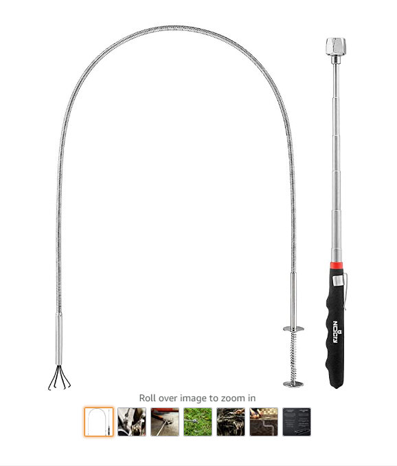

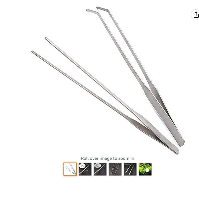

If you could get you to upload a video or an image of the problem, it would help us help you. You may be able to use a set of gabbers (image below). Also, you may be able to use compressed air to help blow out any metal that got inside but you need to make sure the intake valve is shut. Check out the images (below). Let us know what happens and please upload pictures or videos of the problem.
