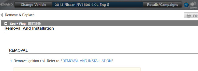

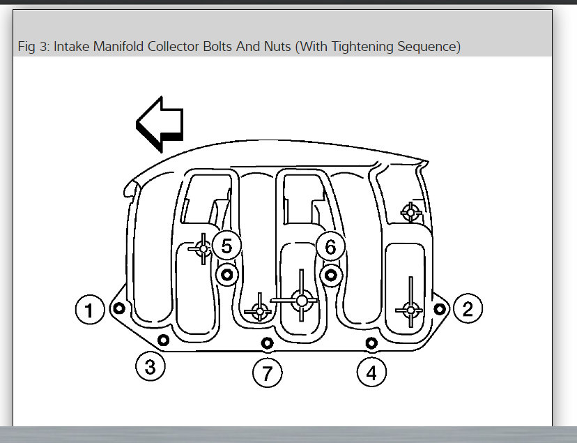

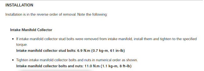

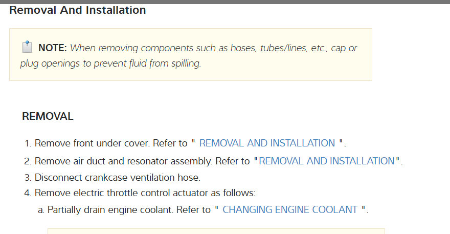

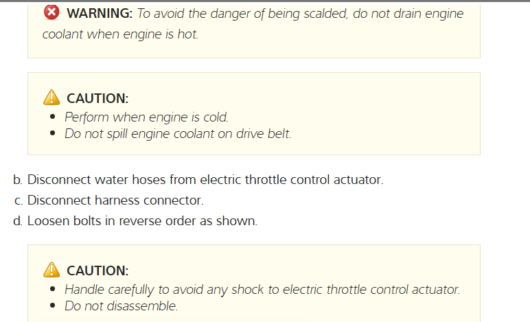

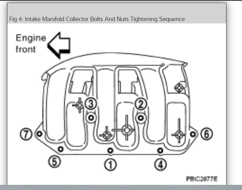

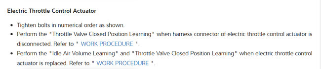

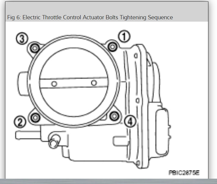

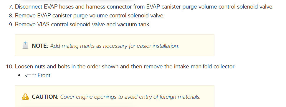

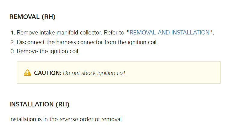

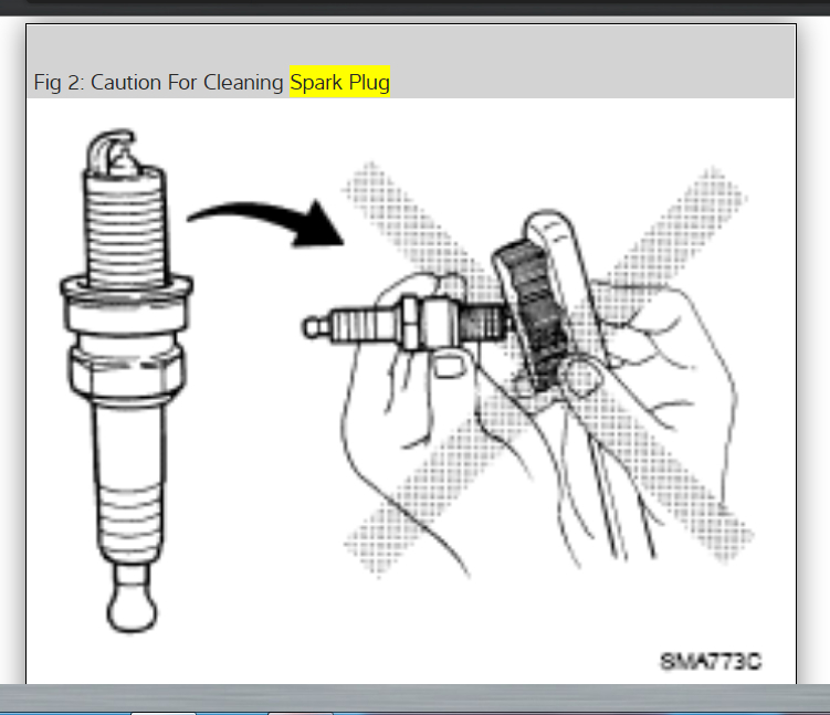

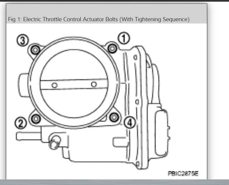

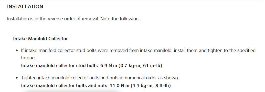

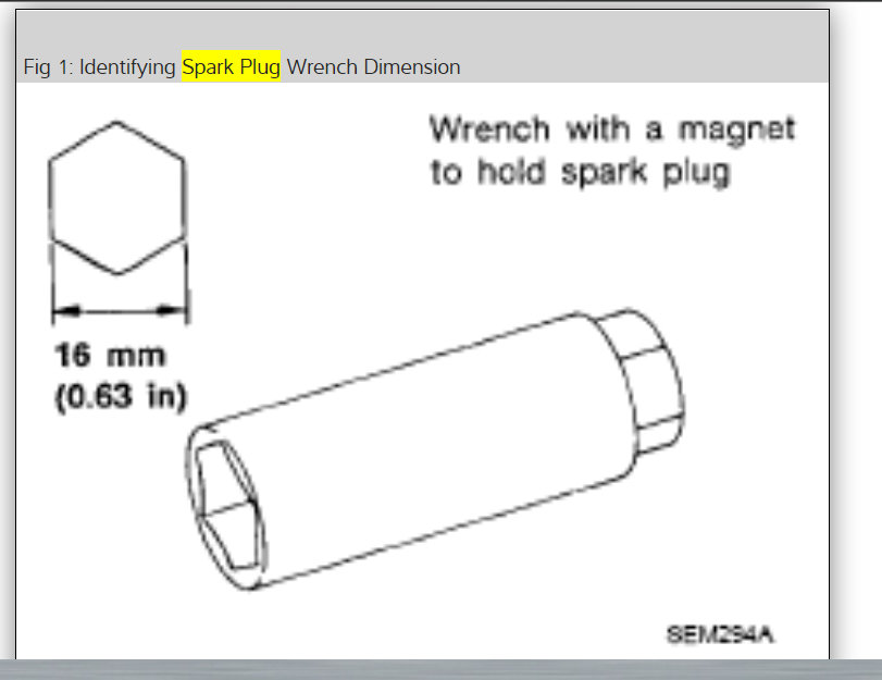

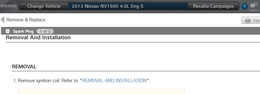

Does the intake manifold/plenum have to be removed to replace the spark plugs on the passenger side of the engine?
May 19, 2019 at 1:16 PM
SCGRANTURISMO
  • 4,897 POSTS
Hello

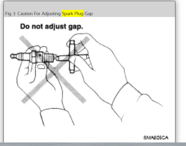

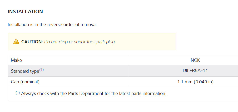

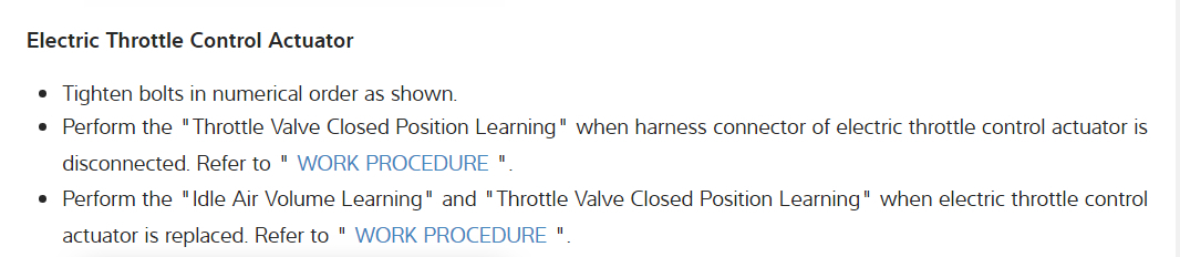

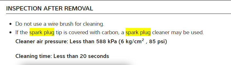

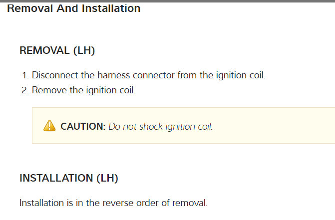

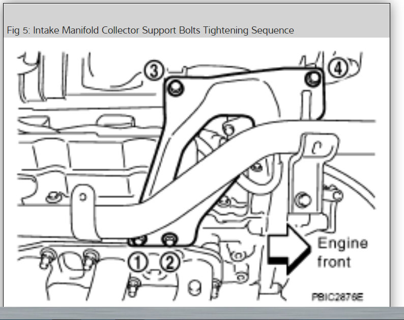

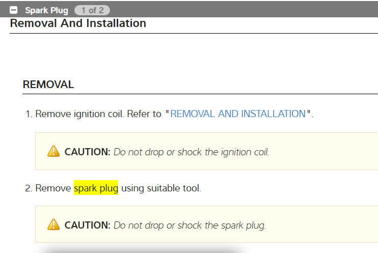

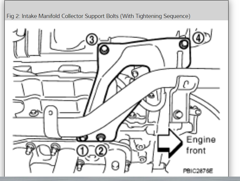

Yes, according to the factory guide for the removal and installation of your vehicle's spark plugs, it does. I have included the factory guide for the removal, inspection, and installation of your vehicle's spark plugs in the diagrams down below. Please go through this guide and get back to us with how everything turns out.
Thanks,
Alex
