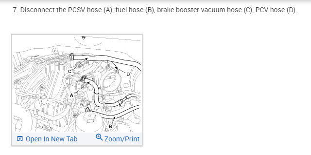

My car listed above EX model has 120,000 miles on it. It's overdue for new spark plugs. How are you supposed to reach the back three spark plugs on this car?
Feb 15, 2023 at 1:30 AM
  • 110,251 POSTS

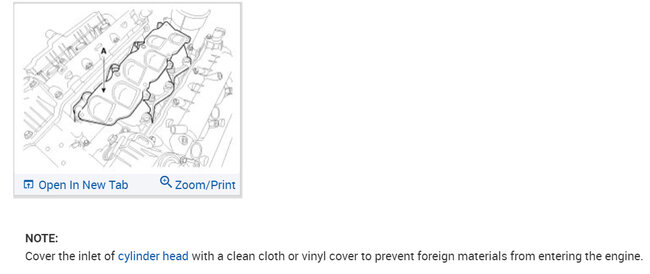

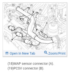

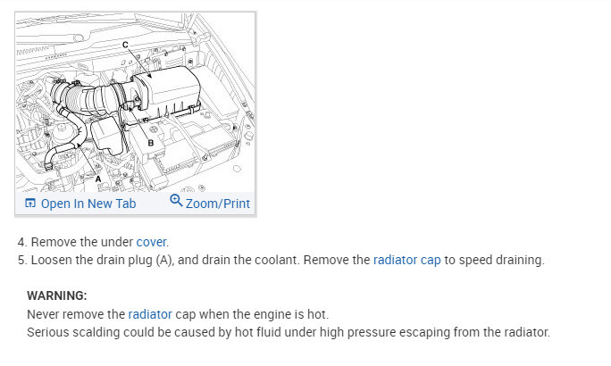

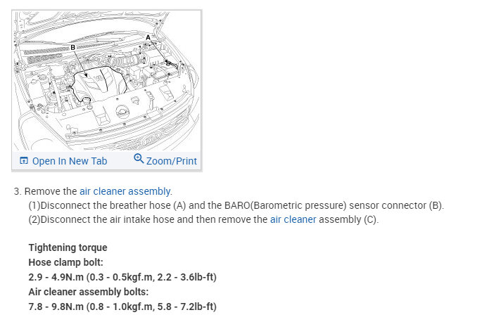

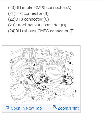

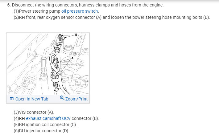

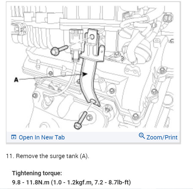

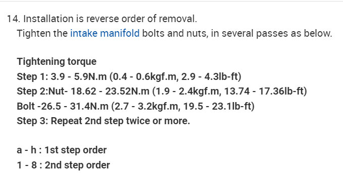

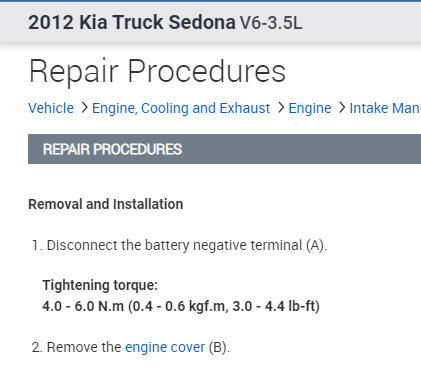

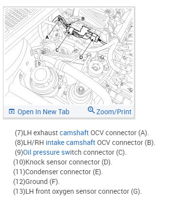

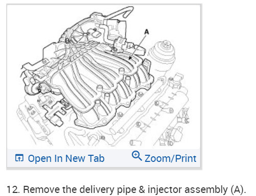

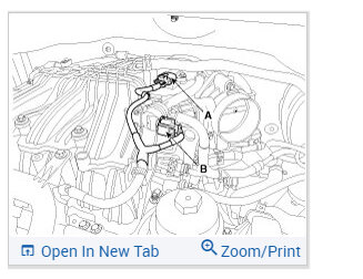

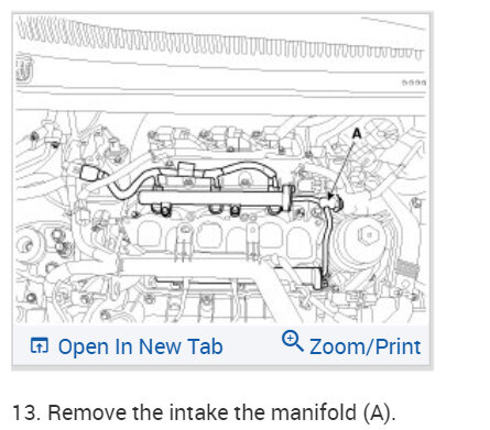

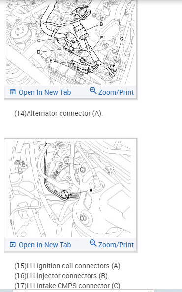

To access the rear three spark plugs, the intake manifold needs to be removed. Anything to make a simple job a bit more difficult. LOL
I attached the directions for the removal and replacement of the manifold. Once it is removed, you will have clear access to the coil packs and spark plugs.
Take a look through the directions below and let me know if you have questions.
Take care and let me know what I can do to help.

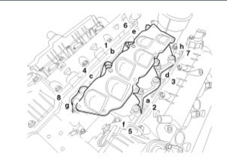

Do I need to replace any gaskets? Or the old gaskets should be fine?
The car is at 120,000 miles. Is there anything else I should bother doing once I'm already in the engine like that? I don't have any o2 codes. Is there any reason to just replace the o2 sensors anyway?
Mar 23, 2023 at 9:18 AM
  • 110,251 POSTS
My first automotive teacher always said, "If it isn't broken, don't fix it." LOL I have lived with that philosophy all my life. Over the years, I have seen so many people replace parts that weren't bad only to create a problem. I would leave the sensors alone.
As far as the gaskets., yes, I would replace them. They are not expensive and if they are original, they will likely leak at this mileage.

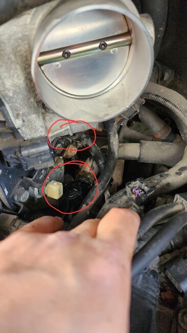

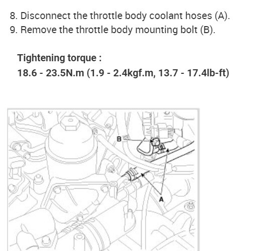

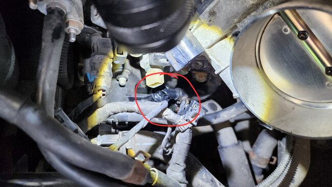

I'm in major trouble. There's 2 coolant hoses coming off the throttle body. One of them attaches to this plastic fitting which cracked. What is that fitting attached to and what are my options?
Apr 23, 2023 at 5:35 AM
EZEX
  • 53 POSTS
Another pic.
EZEX
  • 53 POSTS
Cancel! It's part number 25672-3c200.
But from the bolts holding down the throttle body one is a shorter 14mm bolt that mounts the throttle body to the car body. What's the screw size? Lost that screw and need to get a replacement.
Apr 23, 2023 at 6:52 AM
  • 110,251 POSTS
As far as the bolt is concerned, that isn't provided in my manuals. However, the ones that were longer should be the same thread pitch and diameter. Do you remember approximately how much shorter it was? Can you gauge a length by looking at the part vs where it bolts?
