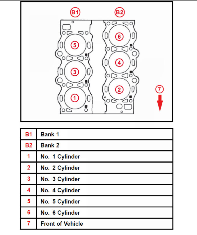

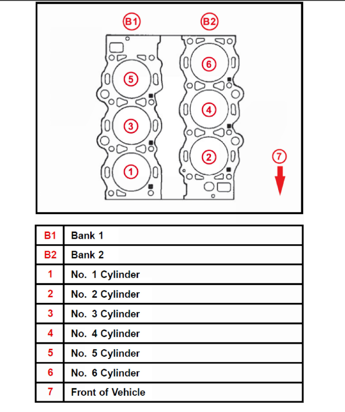

Where are cylinders 5 and 6 for the spark plugs located? Can you please show with pictures?
May 8, 2025 at 2:23 PM
CANNON1349
  • 861 POSTS
I have attached an engine diagram of the cylinder identification. Keep in mind the spark plug torque is 18ft/lbs.
