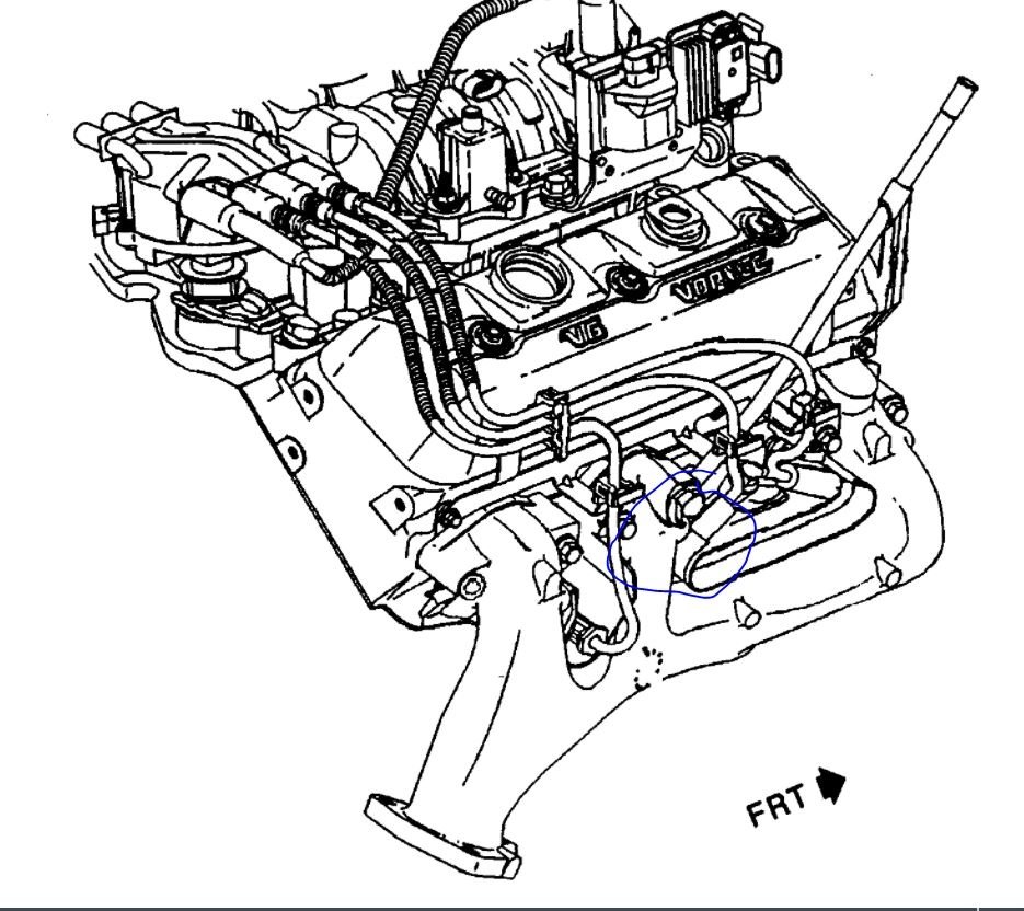

Cylinder four has a misfire. where is spark plug number four located and easiest way to change it?

It is the second one back on the passenger bank.
It is easiest by going through the wheel well. Remove the tire and use a long extension.
